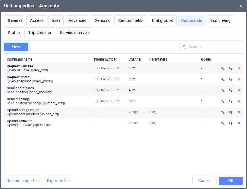

Creating commands
To create a command, click New, specify its properties, and click OK.
