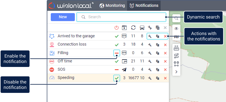

On the tab, you can see a list of all the available notifications. Above the list, there is a button for creating notifications and a dynamic search by different criteria.
s If the background of a notification in the list is orange, it means that you should change its settings because it poses a threat to the performance of your system. This may occur for two reasons:
  • the execution time of the notification exceeds 10 minutes (for example, when the specified time interval or number of units is too large in a notification with the Send a report by email action);
  • the notification has been triggered more than 10,000 times within an hour (for example, when the For all messages option is unnecessarily enabled in the notification settings).

You can also perform the following actions in the list:
IconAction
Disable the notification (the icon changes to  as a result).
Enable the notification (the icon changes to  as a result).
Edit the notification parameters, or view them if you don't have the Create, edit and delete notifications access right.
Copy the notification, that is, create a new notification using the current one as a template.
Delete the notification.
