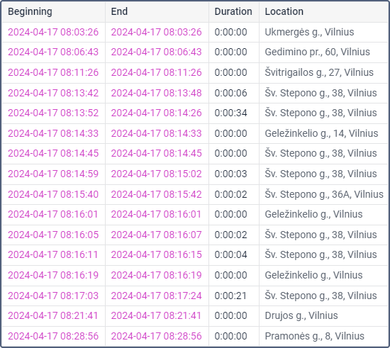

The Stops table can contain the following columns.
Column Description
Beginning The time when the stop started, that is, the time of the first message with the speed lower than the value from the Min. moving speed field.
End The time when the stop ended, that is, the time of the last message with the speed lower than the value from the Min. moving speed field.
Duration The time between the beginning and the end of the stop.
If an interval has only one message with a speed value lower than the minimum speed, the time of this message is considered to be both the beginning and the end of the stop. In such a case, this column shows 0:00:00.
Total time The time from the beginning to the end of stop. It is recommended to use this column in combination with the grouping parameter or the Total row. If the Total row is configured in the table, it shows all the time that elapsed from the start of the first stop to the end of the last one.
Off-time The time from the end of the previous stop to the beginning of the current one (to be defined beginning from the second stop).
Location The address where the unit stopped.
Coordinates The coordinates of the unit at the moment of a stop (in decimal degrees).

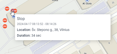

The Stops table can be supplemented with the corresponding markers on the map.
