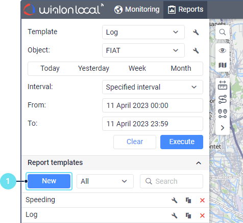

To create a report template, follow the next steps:
  1. In the Report templates section, click New.
  2. Select the resource where the template should be stored if you have more than one resource available.
  3. Specify a name for the report. Under this name it will be shown in the list of templates.
