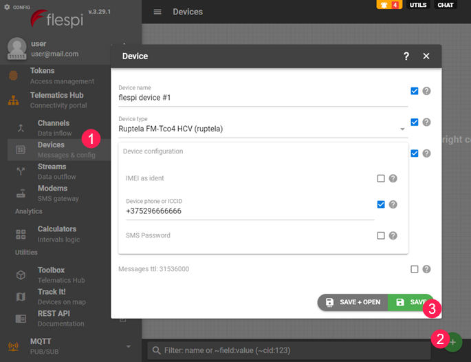

  1. Create a device in flespi. To do this, open the Devices tab in the Telematics Hub, click on the button  in the lower right corner of the screen, fill in the required fields, and click Save.

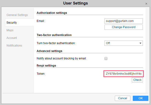

  6. Copy a token on the flespi platform (the Tokens tab).
  7. In Wialon, paste the copied token into the Token field on the Security tab of the top account settings.

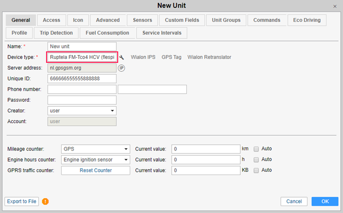

  8. Create a unit in Wialon. The device type should be the one indicated in the Device type field in step 1. It should be marked as flespi in brackets.

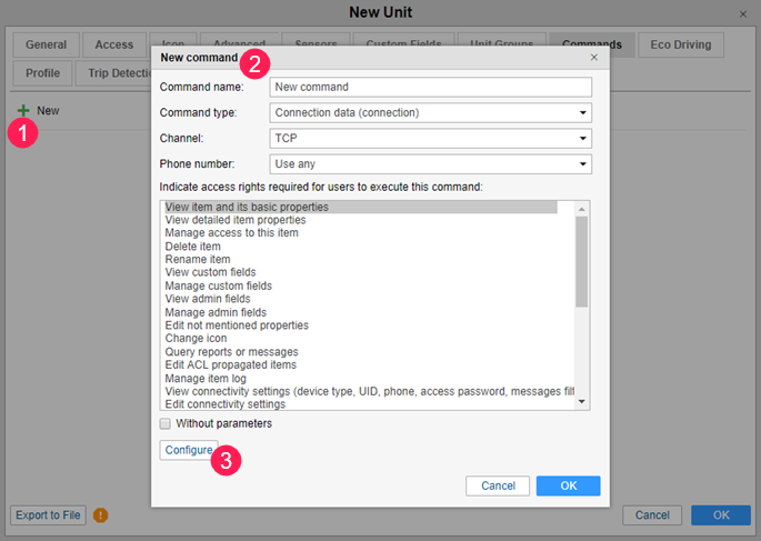

  9. Create a new command: click New on the Commands tab in the unit properties. Create a new command.

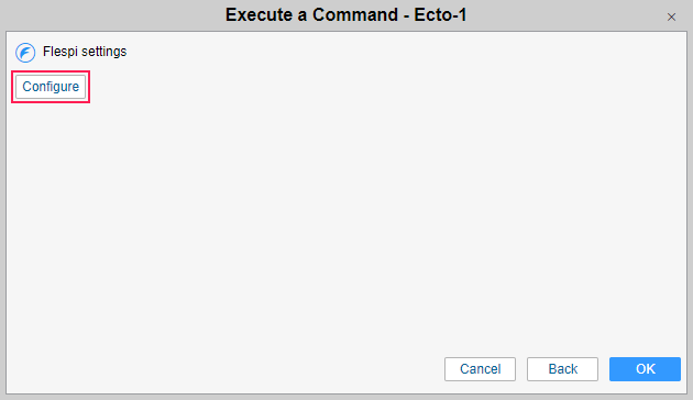

  10. Click Configure to configure command parameters in the flespi form.
    In this way, you will not have to do it manually every time before sending the command to the unit.

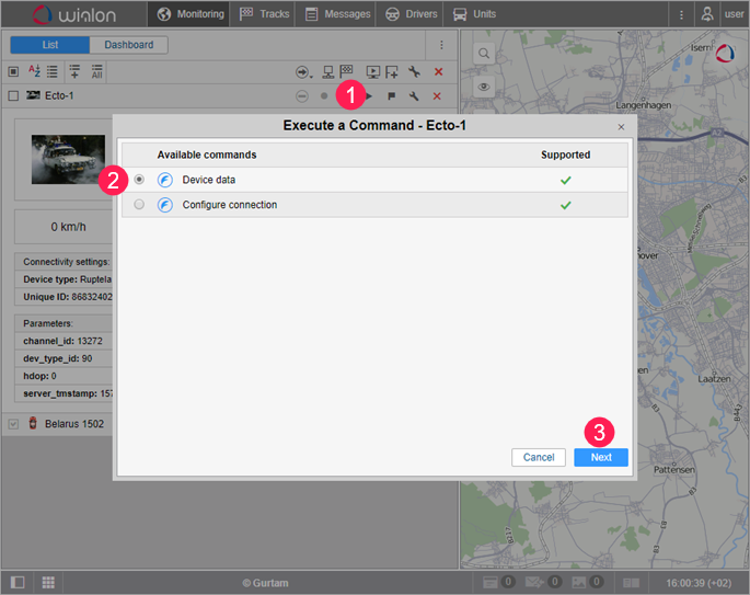

  11. Select the command to send to the unit from the Monitoring tab.
  12. Click OK.
  13. If the parameters of the command were not configured in its settings, specify them in this step.
