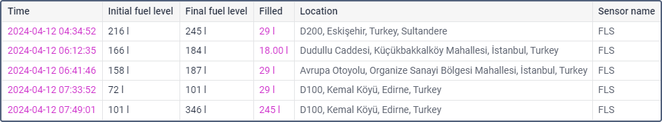

The Fuel fillings and battery charges table allows you to find out where and when the vehicle was refilled and/or recharged. The table is generated taking into account the fillings and charges registered manually and those detected by sensors. To learn how to properly configure the parameters used in the report, see the pages Additional settings of FLS and Additional settings of battery level sensors. If no fuel fillings or charges are found for the indicated report interval, the table is not generated.
The Fuel fillings and battery charges table can contain the columns described below.

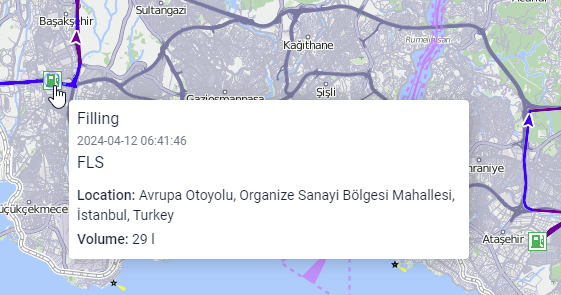

The Fuel fillings and battery charges table may show rows with fillings and drains marked as false. To do this, the Show false events option must be enabled in the report settings.
The interval filtering by geofences/units, drivers, trailers, fuel fillings, battery charges and sensor masks can be additionally applied to this table.
You can use special markers for this report to mark places of fillings and battery charges on the map.
