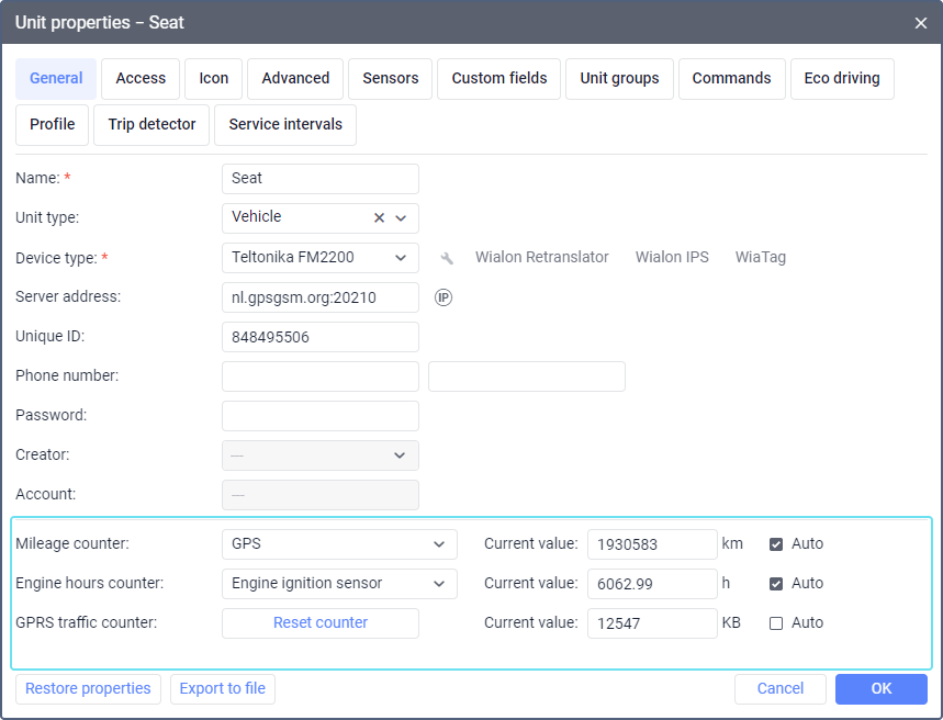

On the General tab, apart from other properties, you can configure the mileage, engine hours and GPRS traffic counters.
Mileage counter
You can select one of the following mileage calculation methods:

  • Check the mileage counter settings on the General tab of unit properties.

Counter values
In the Current value field opposite each counter, you can specify the value from which mileage, engine hours or traffic should be calculated.
For the counter values, the following limitations apply:
CounterMaximum value
Odometer2 668 767 km or 4 294 967 miles
Engine hours counter1 193 046
GPRS traffic counter4 194 303
Enable the Auto option to the right of the field in order for new data to be added to the specified value automatically.
To reset counter values manually, type 0 in the Current value field.
