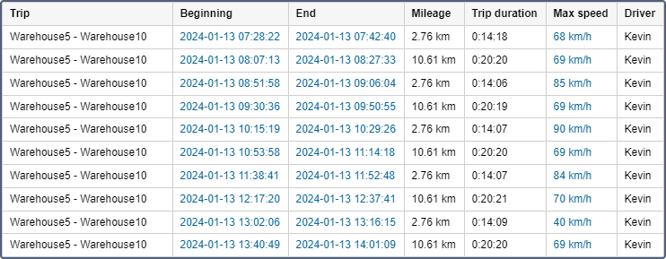

The Unfinished trips table shows the unit’s incomplete trips from one geofence to another. A trip is considered to be unfinished when the unit leaves the starting point, and then, not having visited any of the final points, again appears in the point marked as the beginning. It can be the same zone from where the unit left (if circle trips are not allowed) or some other geofence with a starting point mark.
The Unfinished trips table contains the columns described below.
Column Description
Trip The departure and destination point.
Trip from The departure point.
Trip to The destination point.
Beginning The date and time when the trip began.
End The date and time when the trip ended.
Mileage The distance travelled during the trip.
Mileage (adjusted) The mileage subject to the coefficient set in the unit properties on the Advanced tab.
Trip duration The amount of time it took to perform the trip.
Total time The time from the beginning to the end of trip. It is recommended to use this column in combination with the grouping parameter or the Total row. If the Total row is configured in the table, it shows all the time that elapsed from the start of the first trip to the end of the last one.
Parkings duration The time spent on parkings.
Avg. speed The average speed calculated for the trip.
Max. speed The maximum speed registered during the trip.
Driver The name of the driver (if identified).
Trailer The name of the trailer (if it was assigned).
