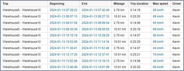

Unfinished Trips
See the Trips between geofences topic to learn how to prepare trips for this report.
A trip is considered to be unfinished when the unit leaves the starting point, and then, not having visited any of the final points, again appears in the point marked as the beginning. It can be the same zone from where the unit left (if circle trips are not allowed) or some other geofence with a starting point mark.
The available columns are described below.
ColumnDescription
TripThe departure and destination point.
Trip fromThe departure point.
Trip toThe destination point.
BeginningThe date and time when the trip began.
EndThe date and time when the trip ended.
MileageThe distance travelled during the trip.
Mileage (adjusted)The mileage subject to the coefficient set in the unit properties on the Advanced tab.
Trip durationThe amount of time it took to perform the trip.
Total timeThe time from the beginning to the end of trip. It is recommended to use this column in combination with the grouping parameter or the Total row. If the Total row is configured in the table, it shows all the time that elapsed from the start of the first trip to the end of the last one.
Parkings durationThe time spent on parkings.
Avg speedThe average speed calculated for the trip.
Max speedThe maximum speed registered during the trip.
DriverThe name of the driver (if identified).
TrailerThe name of the trailer (if it was assigned).
CounterThe counter sensor value.
Initial counterThe value of a counter at the moment of leaving a departure geofence.
Final counterThe value of the counter at the moment of entering a destination end.
CountThe number of trips (can be helpful either when grouping the table data by years/months/weeks/days/shifts or for the reports on unit groups).
StatusThe unit status registered during the trip. It can be registered manually or automatically by means of a notification. If there are several registered statuses, the first of them is displayed.
ConsumedThe volume of consumed fuel detected by any sort of fuel sensor. If several such sensors are available, their values sum up.
Consumed by ImpFCS/AbsFCS/InsFCS/FLS/math/math for FLS/ratesThe volume of consumed fuel detected by a fuel sensor (such as impulse/absolute/instant fuel consumption sensor, fuel level sensor) or calculated by math or rates. More information on fuel in reports can be found here.
Avg consumptionThe average fuel consumption by any sort of fuel sensor. If several such sensors are available, their values sum up.
Avg consumption by ImpFCS/AbsFCS/InsFCS/FLS/math/math for FLS/ratesThe average fuel consumption during the trip detected by one of the methods mentioned above.
Initial fuel levelThe fuel level at the beginning of the trip.
Final fuel levelThe fuel level at the end of the trip.
Max fuel levelThe maximum fuel level.
Min fuel levelThe minimum fuel level.
PenaltiesThe penalties calculated for the adjusted Eco driving criteria.
RankThe received penalty points converted into a grade using a 10-point scoring system.
ImageThe images received from the unit. Viewing images in reports and the functions available while doing this are described here.
See the Trips between geofences section to find out more information about the additional parameters for unfinished trips.
