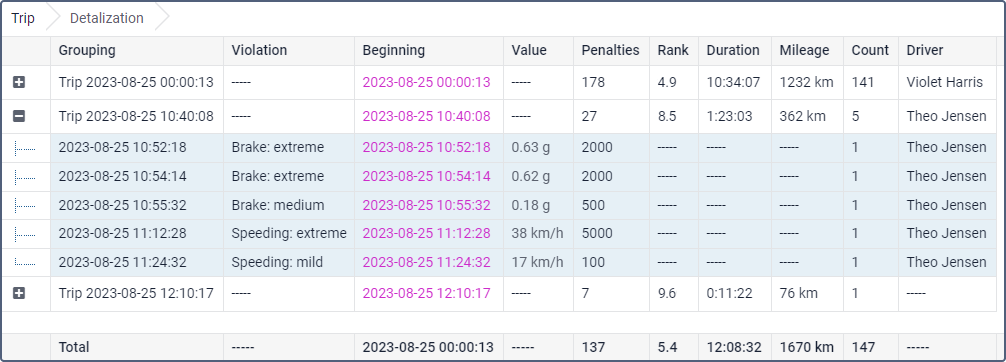

If the Rating by violations column is included in the table, then units/drivers can be placed in the table according to the violations committed (from the lower rating to the highest one). To do this, select the total grouping by rating in the parameters of the report template. The violations rating is calculated by the system on the basis of the eco driving ranks. In case the ranks are similar, the system takes the covered mileage into account. The higher the mileage value with the same rating, the lower the rating by violations is. Note that the system supports the visual marking of the rating fields according to the eco driving rank. To do this, select the colours and the values matching them in the corresponding block of the report template parameters.
Note that it is easier to analyze the received report if the grouping option was applied to the report template. The information received in the report can be grouped on the basis of different criteria, such as time (year, month, week, day, shift), type of violation and trips.
Moreover, in addition to grouping, an option of detalization can be applied. This option allows viewing the final level of nesting (date and time) inside of grouping. However, take into consideration that a penalty and rank can be given for a violation that occurred at a certain time interval (not immediately). That is why on the final level of nesting (date and time) a dash is given in the Rank column, and the Penalty column receives the value indicated on the Eco driving tab of the unit properties.
To display not only violations but all tips, activate the Show all trips option in the Additional parameters block of the Interval filtering section in the table settings.

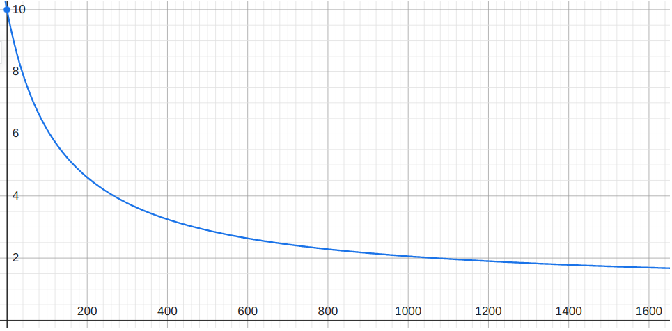

Penalty-rank conversion
The Rank column of the report contains the value calculated on the basis of the received penalty points. It is a score from one to ten.
The following function is used for conversion:
, where
x — number of penalty points,
y — final rank.
