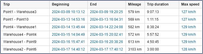

Report on trips
The report on trips gives the list of all performed trips. The table can contain the information described below.
ColumnDescription
TripThis column specifies the start and end point of movement (names of geofences or units are hyphenated).
Trip fromThe departure geofence.
Trip toThe destination geofence.
BeginningThe date and time when the trip began.
EndThe date and time when the trip ended.
MileageThe distance travelled during the trip.
Mileage (adjusted)The mileage subject to the coefficient set in unit properties (Advanced tab).
Trip durationThe duration of travelling from one geofence to another. It can include parking intervals.
Total timeThe time from the beginning to the end of trip. It is recommended to use this column in combination with the grouping parameter or the Total row. If the Total row is configured in the table, it shows all the time that elapsed from the start of the first trip to the end of the last one.
Parkings durationThe total duration of parking intervals while travelling from one geofence to another.
Avg speedThe average speed calculated for the trip.
Max speedThe maximum speed registered during the trip.
DriverThe name of the driver (if identified).
TrailerThe name of the trailer (if it was assigned).
CounterThe counter sensor value (can be helpful either in grouping table data by years/months/weeks/days/shifts or for the reports on unit groups).
Initial counterThe counter value at the beginning of the trip.
Final counterThe counter value at the end of the trip.
Avg temperatureThe average temperature value registered during a trip.
Min temperatureThe minimum temperature value registered during a trip.
Max temperatureThe maximum temperature value registered during a trip.
Initial temperatureThe temperature value at the beginning of a trip.
Final temperatureThe temperature value at the end of a trip.
CountThe number of trips.
StatusThe unit status registered during the current trip. It can be registered manually or automatically by means of a notification. If there are several registered statuses, the first of them is displayed.
Cargo weightThe average value of cargo weight during the trip.
ConsumedThe volume of consumed fuel detected by any sort of fuel sensor. If several such sensors are available, their values sum up.
Consumed by ImpFCS/AbsFCS/InsFCS/FLS/math/math for FLS/ratesThe volume of consumed fuel detected by a fuel sensor (such as impulse/absolute/instant fuel consumption sensor, fuel level sensor) or calculated by math.
Avg consumptionThe average fuel consumption by any sort of fuel sensor. If several such sensors are available, their values sum up.
Avg consumption by ImpFCS/AbsFCS/InsFCS/FLS/math/math for FLS/ratesThe average fuel consumption during the trip detected by one of the methods mentioned above.
Initial fuel levelThe fuel level at the beginning of the trip.
Final fuel levelThe fuel level at the end of the trip.
Max fuel levelThe maximum fuel level.
Min fuel levelThe minimum fuel level.
PenaltiesThe penalties calculated for adjusted Eco driving criteria.
RankThe received penalty points converted into a grade using a 10-point scoring system.
ImageThe images received from the unit. Viewing images in reports and the functions available while doing this are described here.
