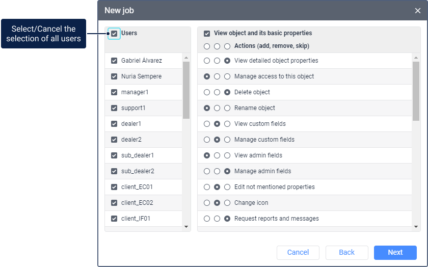

To create a job of this type, follow the guide to creating jobs. In step 4, select the users and select a new set of rights for them as follows:
  • select the option in the left column if you want to add the access right;
  • select the option in the center column if you want to remove the access right;
  • select the option in the right column (selected by default) so that no changes are applied to the access right.
