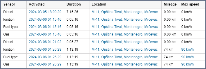

Digital Sensors
Usually, digital sensors have two states: on/off, activated/deactivated, and so on. For example, it can be an ignition or cargo load sensor. All sensors are configured in the unit properties.
To receive the information about a specific sensor, specify its name or part of the name using wildcard symbols — an asterisk * (replaces several characters) or question mark ? (replaces one symbol). The sensor name cannot contain commas. If sensor masks are not specified, the information in the table is displayed for all sensors of the unit.
The table can contain the following columns.
ColumnDescription
SensorThe name of the controlled sensor.
ActivatedThe time from the first message that contains information about the activation of the sensor.
DeactivatedThe time when the sensor was deactivated.
DurationThe interval when the sensor was on.
Total timeThe time from the beginning to the end of sensor activation. It is recommended to use this column in combination with the grouping parameter or the Total row. If the Total row is configured in the table, it shows all the time that elapsed from the beginning of the first activation of a sensor to the end of the last one.
LocationThe location of the unit at the moment the sensor was activated.
Final locationThe location of the unit at the moment the sensor was deactivated.
MileageThe distance travelled while the sensor was on.
Mileage (adjusted)Mileage subject to the coefficient set in the unit properties (the Advanced tab).
Initial mileageThe mileage sensor value at the time the digital sensor is turned on. If the mileage parameter was not saved at the reporting interval, the mileage is counted from zero.
Final mileageThe mileage sensor value at the time the digital sensor is turned off.
Avg speedThe average speed of movement with the sensor on.
Max speedThe maximum speed with which the unit moved with the sensor turned on.
Activations countThe number of activations (can be helpful either in grouping table data by years/months/weeks/days/shifts or for the reports on unit groups).
DriverThe name of the driver (if assigned).
TrailerThe name of the trailer (if assigned).
PenaltiesThe penalties calculated for the adjusted Eco driving criteria.
RankThe penalty points converted to the 10-point rating system.
Avg value of custom sensorThe average value of a custom sensor from the moment of a digital sensor's activation to its deactivation.
Min value of custom sensorThe minimum value of a custom sensor from the moment of a digital sensor's activation to its deactivation.
Max value of custom sensorThe maximum value of a custom sensor from the moment of a digital sensor's activation to its deactivation.
Initial value of custom sensorThe custom sensor value at the moment of a digital sensor's activation.
Final value of custom sensorThe custom sensor value at the moment of a digital sensor's deactivation.
ImageThe images received from the unit. Viewing images in reports and the functions available while doing this are described here.
Interval filtering can be applied to this table: by duration, mileage, engine hours sensor, engine hours, speed range, trips, stops, parkings, sensors masks, driver, trailer, fuel fillings, fuel drains, and geofences/units.
