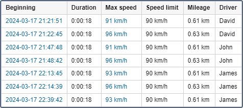

Speedings

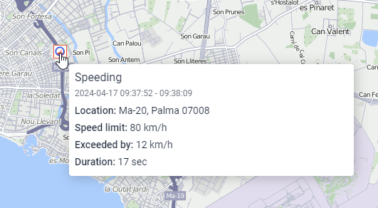

This kind of report shows speed limitation violations. The speed limit depends on the method for determining the speeding selected in the properties of the unit on the Advanced tab.
The information which can be presented in this kind of report is described below.
ColumnDescription
BeginningThe date and time when the speed limit was exceeded.
LocationThe location of the device at the moment of speeding.
DurationThe time interval during which the unit was moving with an excessive speed. If the speeding was determined by one message, in the line 00:00 is written. In order for the speeding to be determined also by one message, it is necessary to indicate 0 as the minimum speeding time in the advanced properties of the unit.
Total timeThe time from the beginning to the end of speeding. It is recommended to use this column in combination with the grouping parameter or the Total row. If the Total row is configured in the table, it shows all the time that elapsed from the start of the first speeding to the end of the last one.
Max speedThe maximum speed within the period of speeding.
SpeedThe speed at the time of the maximum speeding, that is, at the moment of the maximum difference between the permitted and actual speed.
Speed limitThe maximum allowed speed on a particular road section or in the unit properties.
MileageThe distance travelled with the exceeded speed.
Mileage (adjusted)The mileage subject to the coefficient set in unit properties (the Advanced tab).
Initial mileageThe mileage sensor value at the moment of the beginning of speeding. If no saving of mileage parameter was made through the reported period, the mileage is counted from 0.
Final mileageThe mileage sensor value at the end of the speeding interval.
Avg speedThe average speed within the interval.
DriverThe name of the driver (if identified).
TrailerThe name of the trailer (if it was assigned).
CountThe number of speed violations.
ImageThe images received from the unit. Viewing images in reports and the functions available while doing this are described here.
Interval filtering (by speeding duration, mileage, driver, geofences/units) can be applied to this table.
