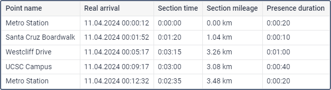

Check Points
Route points refer to check points indicated when creating a route. The table can include the columns described below.
ColumnDescription
Point nameThe name which is given to this checkpoint while creating it.
Real arrivalThe time when the unit entered the checkpoint.
Scheduled arrivalThe time when the unit was supposed to enter the checkpoint according to the schedule.
Initial locationThe location at the time of entry.
Real departureThe time when the unit left the checkpoint.
Scheduled departureThe time when the unit was supposed to leave the checkpoint according to the schedule.
Final locationThe location at the time of departure.
ResultVisited (both entrance and exit were detected), Entrance only, Exit only, Skipped, Finished (entrance to the last point was detected).
RouteThe name of the route to which this checkpoint belongs.
ScheduleThe name of the schedule.
RideThe name of the ride.
Arrival time deviationA positive value if delayed, negative value if in a hurry in regards to the arrival time set in the point properties.
Departure time deviationA positive value if delayed, negative value if in a hurry in regards to the departure time set in the point properties.
Presence durationThe time spent at the checkpoint.
Presence mileageThe mileage at the checkpoint.
Section durationThe time spent to travel from the previous checkpoint to the current one.
Section mileageThe mileage from the previous checkpoint.
CountThe number of points.
DriverThe name of the driver (if available).
TrailerThe name of the trailer (if it was assigned).
