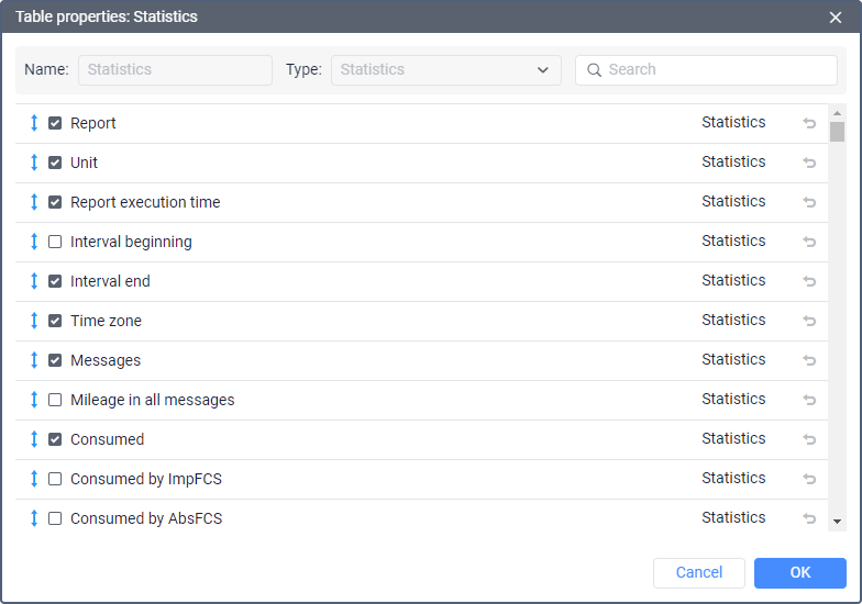

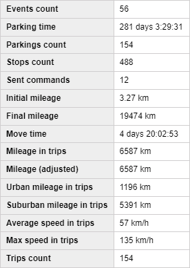

The Statistics table consists of selected rows and their values.
The table gives information on the report as a whole, for example, on the beginning and end of the report interval, the number of messages, the name of the unit, the time zone, the time of report execution, and other statistics, depending on the selected report template type.
To add the statistics table to a report template, click on the Statistics button on the Report Contents tab of its properties.
In the dialog window of the Statistics table properties, select the rows that should be included in the table. To find the required ones, use the dynamic search located in the upper right corner. Search is carried out both by the name of the row (to the left) and by the type to which it belongs (to the right).
To change the name of the row, click on it with the left mouse button and make the changes. To cancel the changes, click on the Default icon (). The icon is inactive if the name has not been changed.
You can also change the sequence of the rows. To do this, drag the icon located to the left of the required row name.
The statistics table is added to the list of contents of the report template. It always goes first and cannot be moved.
