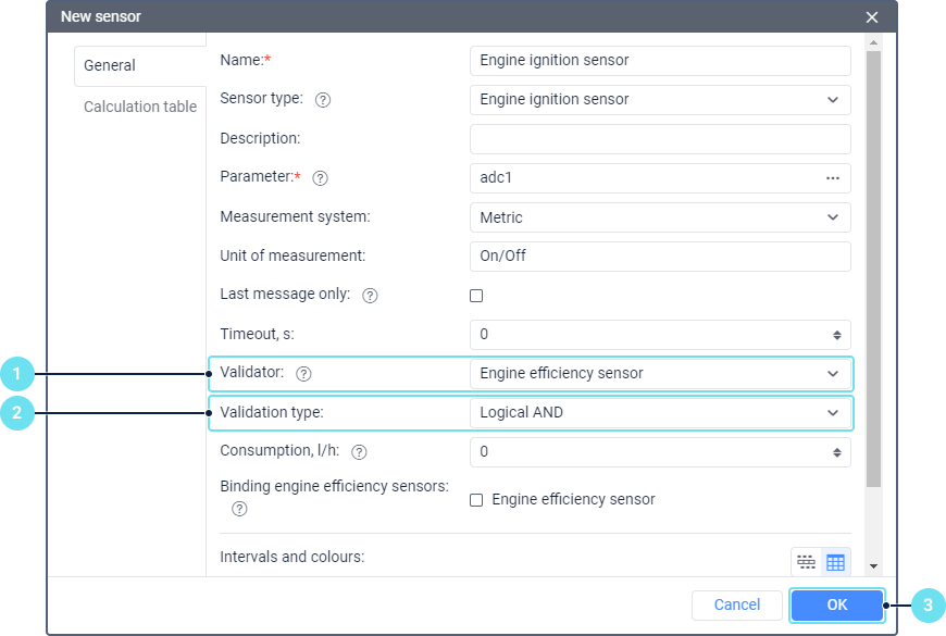

Validation determines the dependence of the main sensor on a validator and makes it possible to combine their values to get one final value. You can configure validation by selecting a validator and validation type in the sensor properties.
A validator is a validation sensor that can change the value of the main sensor. The validator is selected from the list of available sensors that were created earlier for the same unit. When creating a sensor by copying, you cannot select the source sensor as a validator.

Types of validation
A validation type is a logical or mathematical operation in which a validator can influence the final value of the main sensor. There are 12 types of validation, each of which is described below.
