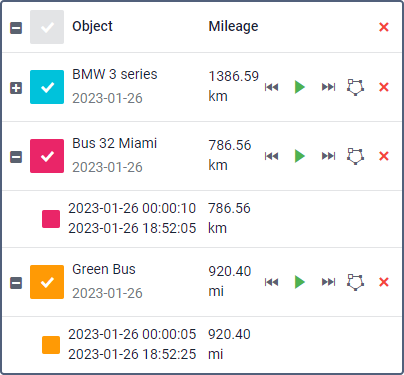

Track list
The list of tracks is displayed in the left part of the window under the Show track button. Each line shows the unit name, the colour of the track (or the colour of its first segment), the mileage for the specified interval, and the interval itself.
The mileage in the tracks may differ from the mileage in reports if invalid data was received during the specified interval. In such cases, the mileage in reports should be considered more accurate.
On the map, you can see all the tracks at the same time or only the required ones. Select a track in the list to display it on the map. Check the box in the list header to select all tracks at once, or clear the checkmark to cancel the selection of all the tracks.
You can sort the tracks in the list by unit name or mileage. To do this, click on the Object or Mileage heading, respectively. Click on the heading again to reverse the sorting order.
To see the whole track and centre the map on it, click on its row in the list. To perform actions with tracks, the following icons are available:
Icon
Description
Expand/Collapse the list of trips the track consists of. The icon is shown only if the Apply trip detector option was activated when requesting the track.
Go to the start/end point of the track.
Open the Track player tool and start playing the track. The unit icon moves along the track at the selected speed.
Save the track as a geofence in the shape of a line. If the number of points in a track exceeds 10,000, it is divided into several geofences with the same name and a numerical index in brackets (for example, Geofence name (1), Geofence name (2), etc.).
Remove the track from map. When you click on this icon in the list header, all the tracks are deleted from the map.
