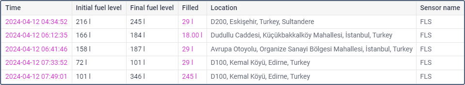

This report table allows you to find out where and when the vehicle was refilled. The table is generated taking into account the fillings registered manually and those detected by fuel level sensors. The parameters for the report are set in the properties of fuel level sensors. If no fuel fillings are found for the indicated report interval, the table is not generated.
The table can contain the columns described below.
ColumnDescription
TimeThe moment of the most significant change in the fuel level.
LocationThe location of the unit at the time of filling (if a filling is registered manually, the location of the unit is detected on the basis of the messages received at the time of filling registration).
Initial fuel levelThe fuel level before the filling.
Final fuel levelThe fuel level after the filling.
FilledThe volume of filled fuel (the name of the sensor can be indicated in parenthesis).

The table may show rows with fillings and drains marked as false. To do this, the Show false events option must be enabled in the report settings.
The interval filtering by geofences/units, drivers, trailers, filling volume, and sensor masks can be additionally applied to this table. Note that in the case of sensor masks, interval filtering is only applied to the fuel filling detected by sensors.

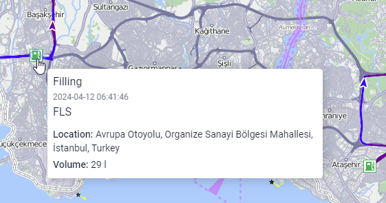

You can use special markers for this report to mark places of fillings on the map.
