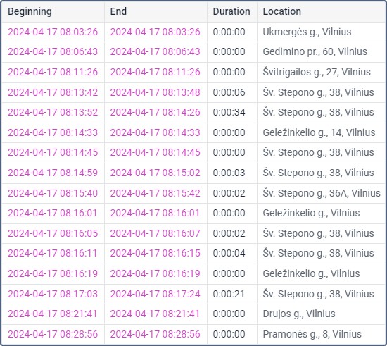

ColumnDescription
BeginningThe time when the stop started, that is, the time of the first message with the speed lower than the value from  the Min. moving speed field.
EndThe time when the stop ended, that is, the time of the last message with the speed lower than the value from  the Min. moving speed field.
DurationThe time between the beginning and the end of the stop.
Total timeThe time from the beginning to the end of stop. It is recommended to use this column in combination with the grouping parameter or the Total row. If the Total row is configured in the table, it shows all the time that elapsed from the start of the first stop to the end of the last one.
Off-timeThe time from the end of the previous stop to the beginning of the current one (to be defined beginning from the second stop).
LocationThe address where the unit stopped.
CoordinatesThe coordinates of the unit at the moment of a stop (in decimal degrees).
DriverThe name of the driver (if available).
TrailerThe name of the trailer (if it was assigned).
CountThe number of stops.
CounterThe counter sensor values (can be helpful either in grouping table data by years/months/weeks/days/shifts or for the reports on unit groups).
Avg weightThe average weight value registered for the stop interval.
Min weightThe minimum weight value registered for the stop interval.
Max weightThe maximum weight value registered for the stop interval.
Initial weightThe weight value at the beginning of the stop interval.
Final weightThe weight value at the end of the stop interval.

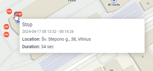

This kind of report can be supplemented with the corresponding markers on the map.
