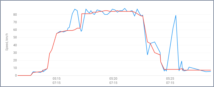

Smoothing
Almost all regular charts have two forms: a raw form and a smoothed one (the word smoothed is indicated in brackets after the name). Smoothing affects the style of displaying the lines. Raw data charts are built strictly from message to message, and, as a result, have angular outlines. Smoothed charts have smoother outlines because they use a smoothing algorithm. It is the same for all charts and is not customizable.
Below is an example of a chart in which a blue line shows a raw speed chart, and a red one shows a smoothed speed chart.

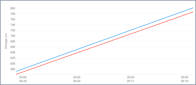

Regular mileage charts
Four kinds of mileage charts can be created: absolute mileage, mileage in trips, instant mileage, and instant mileage smoothed. The first two show how mileage changed (increased) over time. Absolute mileage chart is built on the basis of all messages, which means that any inaccuracy and outlying data affect the resulting chart. Mileage in trips chart displays the data taking trip detector settings into account. Below you see the chart with curves for absolute mileage (blue) and mileage in trips (red).

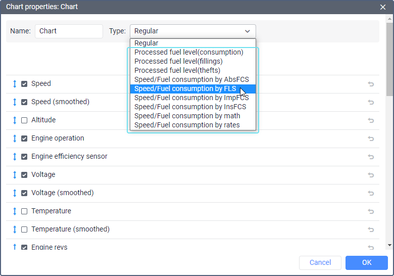

Special charts
Along with the regular charts, the following special charts are available:
  • Processed fuel level (consumption);
  • Processed fuel level (fillings);
  • Processed fuel level (drains);
  • Speed/Fuel consumption by AbsFCS;
  • Speed/Fuel consumption by FLS;
  • Speed/Fuel consumption by ImpFCS;
  • Speed/Fuel consumption by InsFCS;
  • Speed/Fuel consumption by math;
  • Speed/Fuel consumption by rates.
Settings for these charts are fixed and cannot be changed. Editing is available only for the name of the chart. Also, it is possible to select the required sensors (indicate the mask of the sensor).

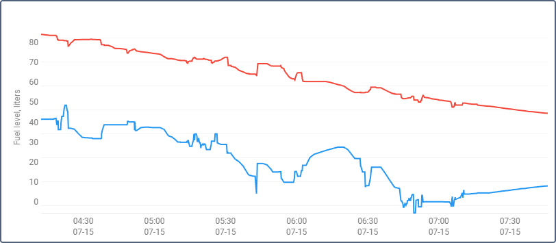

The special Processed fuel level chart shows the values which are used while calculating fuel level, fillings and drains in tables.
The chart shows the dependence of fuel level on mileage (litres/mileage). It can also show the dependence of the fuel level on time (litres/time) if the Calculate fuel consumption by time option is turned on in the sensor settings. In both cases, the chart is processed taking into account the filtering which is also set in the sensor settings.
The special Processed fuel level chart should be distinguished from two similar regular charts.
Below is the special Processed fuel level (consumption) chart. The Calculate fuel consumption by time option is enabled, median filtering is configured, the filtering level is 3.

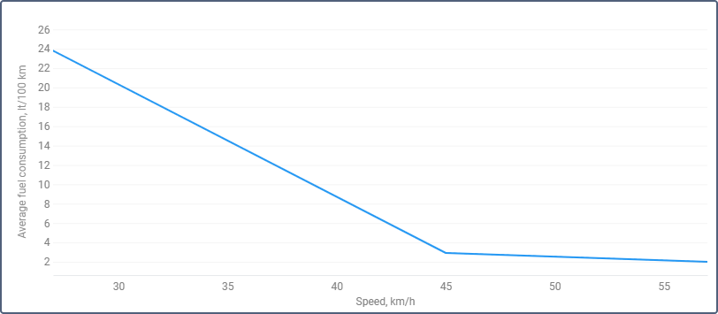

Speed/Fuel consumption chart
This chart shows the dependence of average fuel consumption on speed. The data for it is taken from fuel consumption sensors of different types (such as impulse, absolute, instant) or fuel level sensor, or predefined consumption by math or rates. The calculation methods must be specified in the properties of the required sensors.
