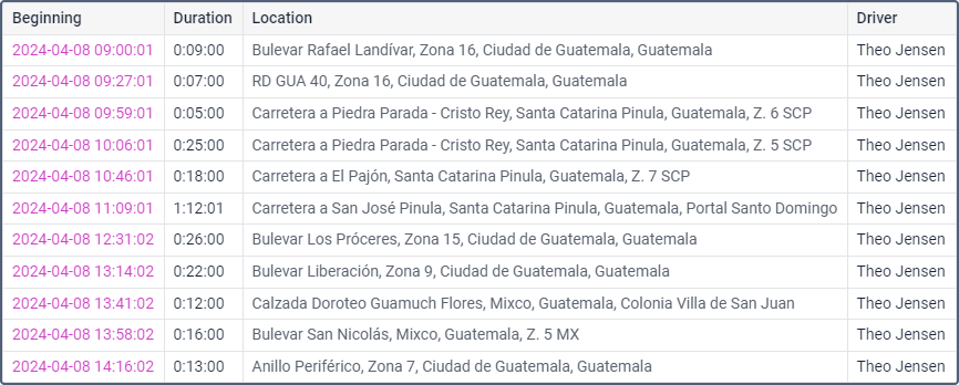

The information which can be presented in this kind of report is described below.
Column Description
Beginning The time when the parking started.
End The time when the parking ended.
Duration The time interval of a parking.
To determine the parking duration, at least two messages with speed values that are less than the specified minimum moving speed should be received from the unit.
Total time The time from the beginning to the end of parking. It is recommended to use this column in combination with the grouping parameter or the Total row. If the Total row is configured in the table, it shows all the time that elapsed from the beginning of the first parking to the end of the last one.
Off-time The time interval from the end of the previous parking to the beginning of the current parking (defined starting from the second parking).
Location The address where the unit was stationary. If there was an insignificant movement detected, the initial unit location is indicated. If the unit location is not available during the parking interval, then it is determined by the initial unit location on the trip that follows the parking.
Coordinates The coordinates of the unit during the parking (in decimal degrees).
Driver The name of the driver (if available).
Trailer The name of the trailer (if it was assigned).
Counter The values of the counter sensor.
Initial counter The counter value at the beginning of the parking.
Finale counter The counter value at the end of the parking.
Avg temperature The average temperature value registered for the parking interval.
Min temperature The minimum temperature value registered for the parking interval.
Max temperature The maximum temperature value registered for the parking interval.
Initial temperature The temperature value at the beginning of the parking interval.
Final temperature The temperature value at the end of the parking interval.
Avg weight The average weight value registered for the parking interval.
Min weight The minimum weight value registered for the parking interval.
Max weight The maximum weight value registered for the parking interval.
Initial weight The weight value at the beginning of the parking interval.
Final weight The weight value at the end of the parking interval.
Status The unit status registered during the current parking interval. It can be registered manually or automatically by means of a notification. If there are several registered statuses, the first of them is displayed.
Count The number of parkings (useful when grouping rows by years/months/weeks/days/shifts or for the reports on unit groups).
Notes An empty column for your custom comments.
Image The images received from the unit. Viewing images in reports and the functions available while doing this are described here.
See Data in reports to learn how time (duration) can be formatted.
The interval filtering (by parking duration, sensor state, driver, trailer, fuel fillings/drains, and geofences/units) can be applied to this table.

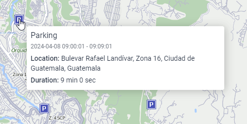

The parkings can be displayed on the map. To make use of this feature, select Parking markers in the report template.
