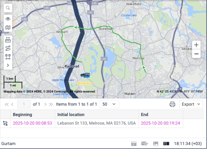

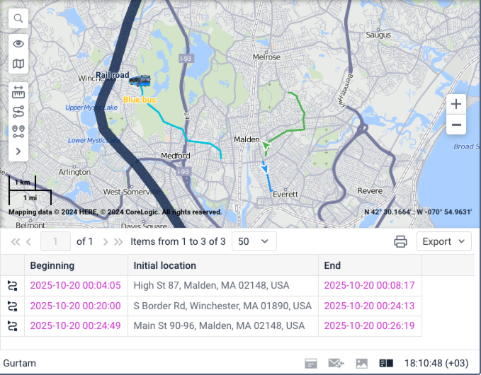

Geofences/Units
The filter allows you to see those intervals within which the unit was inside or outside of the selected geofence or area around the selected unit. Only geofences that belong to the same resource as the report template itself can be displayed here.
By default, the intervals are shown entirely. To see only those parts of the interval during which the unit was inside or outside of the geofence/unit area, enable the Retrieve intervals option.
The filter section consists of two lists: the list of geofences and the list of units. Above each list, there is a dynamic search by item name.
For each list item, you can specify one of three statuses:
  • : The item (geofence or unit area) is not taken into account.
  • : Intervals inside this geofence or unit area. The report table includes those intervals where the unit sent at least one message inside the selected geofence (or unit area). Example. In the image below, the Trips table is filtered by the Inside “Railroad” geofence criterion. It includes a trip during which the vehicle sent messages within this geofence, though only briefly.
  • : Intervals outside this geofence or unit area. The report table includes those intervals where the unit sent all messages outside the selected geofence (or unit area).
    Example. In the image below, the Trips table is filtered by the Outside the “Railroad” geofence criterion. It includes three trips which had no message inside this geofence.

Example 2. A report on trips is being executed. It is known that the unit travelled at speeds above 90 km/h during the indicated period of time. On the unit track the speed above 90 km/h is marked in orange colour, and above 120 km/h is marked in red colour. The user needs to show in the report only the segments where the unit travelled at a speed of 89 km/h and above (Image 1). Image 1
To do this, in the Speed filter, specify a minimum value of 89 km/h. If you execute the report with these settings, it will show the entire interval where the speed was higher than 89 km/h (Image 2). Image 2
To show in the report only those segments where the speed was higher than 89 km/h, you need to enable the Retrieve intervals option in the Speed filter.
This will exclude the segments marked on the track with purple and blue colour (Image 3). Image 3
