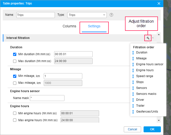

Interval Filtration
When executing most tabular reports in the Wialon system, time intervals corresponding to the table type are retrieved from the unit history. For example, the intervals refer to the unit trips in a report on trips, while in a report on geofences, the intervals refer to the unit being within a geofence. You can apply filtration to these intervals on the basis of certain parameters. For example, the report can show only those trips that lasted longer than the specified time, or only those geofence visits during which the vehicle was parked.
You can see the Interval filtration section on the Settings tab of the table properties. The available filters, that is, the parameters on the basis of which filtration is carried out, depend on the table type.
You can apply several filters simultaneously. To change the order in which the filters are applied, click on the icon  and drag the list items above or below.
All filters except for the mileage filter work only with integer values.
All the possible filters are described in detail below.

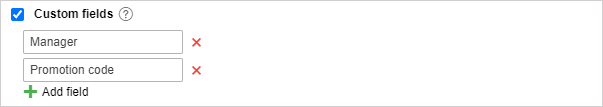

Custom fields
The filter is available in the Orders table and works by custom fields specified in the order properties in the Logistics application. It allows you to specify the names of custom fields which should be shown in the report. If the filter is disabled, the report shows all the custom fields from the orders included in the routes for the selected report interval.

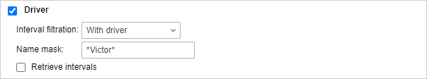

Driver
This filter allows you to include the intervals within which drivers were assigned to the units, or to exclude such intervals from the report.
The following options are available in the filter:
| Option | Description |
| With driver | The report shows those intervals within which drivers were assigned to the units. In the Name mask field, you can specify the name mask of the driver whose intervals should be included in the report. The mask also works if several drivers were assigned to the unit simultaneously within a certain interval. To see several drivers in the report, enable the Multiple drivers/trailers option in the template settings. Example. A report on trips is executed. During one of the trips, two drivers were assigned to the unit: John and David. If John is specified in the Name mask field, the report shows only those trips, during which only this driver was assigned. If *John* is specified in the field, the report also shows the trip during which the two drivers were assigned. The intervals are shown entirely, regardless of when the driver was assigned: at the beginning, end or middle of the interval. If you want to see exactly the part of the interval during which the driver was assigned to the unit, enable the Retrieve intervals option. Example. The With driver filter is used in a trip report. The trip lasted from 08:00 to 16:00. The driver was assigned to the unit at 14:00 and separated from it at 16:40. If the Retrieve intervals option is disabled, the report shows the entire trip from 08:00 to 16:00. If the option is enabled, only the part of the trip from 14:00 to 16:00 is shown. |
| Without driver | The report shows the intervals during which no driver was assigned to the unit. |
| Driver group | The report displays the intervals during which any driver from the specified group was assigned to the unit. The group name or name mask should be specified in the Name mask field. The principle of extracting intervals is the same as in the case of the With driver option (see the description above). |

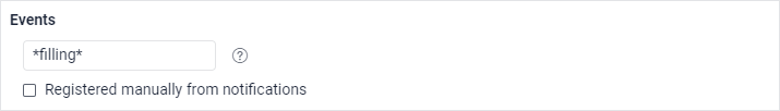

Events
This filter is available for the Events and Violations tables. It allows you to see only those events the text of which matches the specified mask.
If the Registered manually from notifications option is enabled, only custom events registered manually from the online notification window are shown in the report.

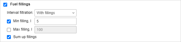

Fuel fillings
This filter allows you to see the intervals within which fuel fillings were detected, or intervals without fillings. In the Min filling and Max filling fields, you can specify the minimum or maximum filling volume which is required for including intervals in the report.
If the Sum up fillings option is enabled, the volumes of all the fillings within the interval are summed up and compared to the value from the Min filling and/or Max filling fields. If the condition is met, the interval is included in the report.
Example. A report on trips is executed. Durin the trip, the system detected fuel fillings of 1 l, 2 l, and 3 l. In the Min filling field, a value of 5 litres is specified. If the Sum up fillings option is disabled, such a trip is not shown in the report. If the option is enabled, the trip is displayed in the report because the total volume of the fillings is 6 litres.

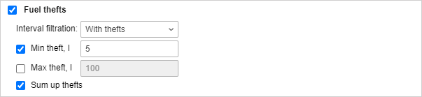

Fuel thefts
The filter allows you to see the intervals within which fuel thefts were detected or intervals with no fuel thefts.
If the With thefts option is selected, then you can specify the minimum and/or maximum amount of fuel drained at one time in the Min theft and Max theft fields in order for the interval to be included in the report. If the Sum up thefts option is activated, then the sum of all thefts within the interval should meet the conditions from the fields.
Example. A report on trips is executed. A value of 5 l is specified in the Min theft field. During the trip, thefts of 2 l, 3 l and 4 l were detected. If the Sum up thefts option is disabled, the trip is not shown in the report. If it is enabled, the trip is shown because the total volume of thefts is 9 liters.

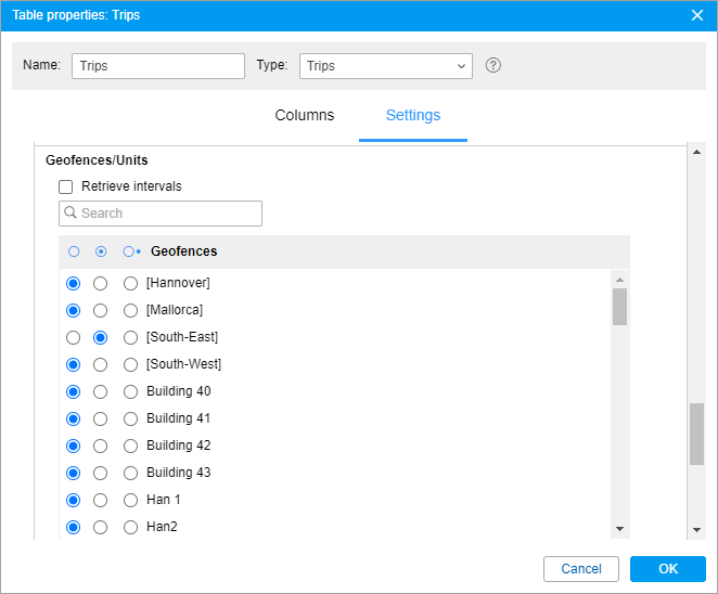

Geofences/Units
The filter allows you to see those intervals within which the unit was inside or outside of the selected geofence or area around the selected unit.
By default, the intervals are shown entirely. To see only those parts of the interval during which the unit was inside or outside of the geofence/unit area, enable the Retrieve intervals option.
When determining the time at which the unit crossed geofences or unit areas, the Maximum interval between messages option from the unit properties is taken into account.
The filter section consists of two lists: the list of geofences and the list of units. Above each list, there is a dynamic search by item name.
For each list item, you can specify one of three statuses:
 : The item (geofence or unit area) is not taken into account. : The item (geofence or unit area) is not taken into account.

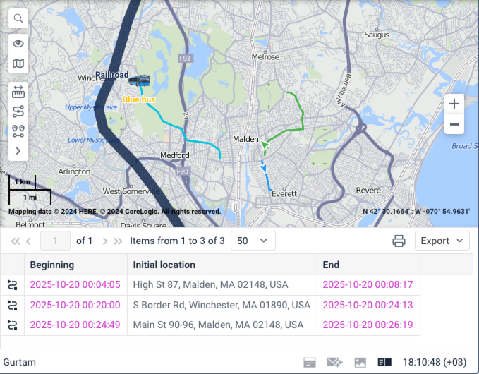

 : Intervals inside this geofence or unit area. The report table includes those intervals where the unit sent at least one message inside the selected geofence (or unit area).
Example. In the image below, the Trips table is filtered by the Inside “Railroad” geofence criterion. It includes a trip during which the vehicle sent messages within this geofence, though only briefly. : Intervals inside this geofence or unit area. The report table includes those intervals where the unit sent at least one message inside the selected geofence (or unit area).

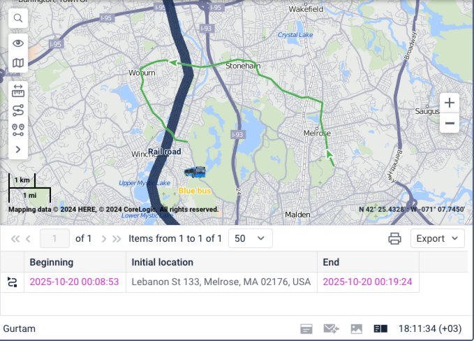

 : Intervals outside this geofence or unit area. The report table includes those intervals where the unit sent all messages outside the selected geofence (or unit area). : Intervals outside this geofence or unit area. The report table includes those intervals where the unit sent all messages outside the selected geofence (or unit area).
 Example. In the image below, the Trips table is filtered by the Outside the “Railroad” geofence criterion. It includes three trips which had no message inside this geofence.
For units, you can specify the radius of the area around them, that is, how close the unit on which the report is executed should be to these units in order for the interval to be included in the report.
To select all the items in the list, hold Ctrl while selecting them. If a group is marked, then all the geofences or units from the group are considered selected. In this case, an interval is shown in the report if any of these geofences and/or unit areas were visited during it.
If the set of units in the selected group changes after creating the report template, then these changes are taken into account at the time of the report execution.
In the properties of the Fuel traffic table, the Include only units with tank fuelling option is available in the Geofences/Units filter. It allows you to see only those units that were refilled within the report interval, when a unit from the report was inside their radius. For example, this option can be used in a situation where a fuel tanker refills several vehicles.

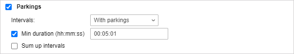

Parkings
The filter allows you to see only those intervals withing which parking periods were detected (With parkings option), or only those intervals within which there were no parking periods (Without parkings option). Parking periods are detected according to the settings in the trip detector. See the detailed description here.
If the With parkings option is selected, you can specify the minimum parking duration in the Min duration field in order for the interval to be included in the report. If the Sum up intervals option is enabled, the duration of all the parking periods within the interval is summed up and compared with the specified minimum duration.
Example. A report on geofence visits is executed. You want the report to show only the visits during which the unit was parked. A value of 10 min. is specified in the Min duration field. The unit had been parked inside the geofence for 5 and for 7 minutes. If the Sum up intervals option is disabled, the geofence visit won’t be included in the report. If the option is enabled, the visit will be shown in the report because the total parking duration was 12 minutes and the minimum duration requirement was met.

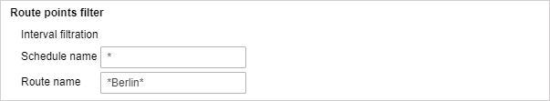

Route points
This filter is available in the Check points table. Here in the Schedule name and Route name fields, you can specify masks for schedules and/or routes, respectively. In this case, the report will only show the check points related to the specified schedules and/or routes.

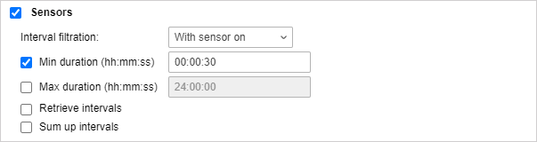

Sensors
This filter allows you to see the intervals within which a sensor of the Digital group was on or off.
The following options are available for the filter:
| With sensor on | The report shows the intervals within which the sensor was on. By default, the intervals in the report are displayed entirely. To see only those parts of the interval during which the sensor was on, activate the Retrieve intervals option. In the Sensor masks filter, you can specify the name of a sensor or a mask for several sensors. If several sensors are specified, the report shows the intervals within which all of them were on at the same time. If no sensor is specified, all the unit sensors are taken into account in the report. |
| With sensor off | The report shows the intervals within which the sensor was off. For this option, you can also retrieve intervals and specify a sensor mask (see the description above). |
| Min duration | The minimum time during which the sensor should be on or off in order for the interval to be shown in the report. |
| Max duration | The maximum time within which the sensor should be on or off in order for the interval to be shown in the report. This option is used if you don't want the report to take into account the sensors that are on for a long time. |
| Retrieve intervals | If the option is disabled, the intervals in the report are shown entirely when they match the filter conditions. If the option is enabled, then the report shows only those parts of the interval during which the sensor was on or off. Each such part occupies a separate line. |
| Sum up intervals | This option can only be used if the Min duration and/or Max duration fields are filled in. If it is enabled, then all the periods during which the sensor was on or off within the report interval are summed up and the result is compared with the specified duration value. If the amount matches the condition, the interval is shown in the report. Example. A report on trips with the sensor on is executed. A value of 60 seconds is indicated in the Min duration field. The Sum up intervals option is activated. During the trip, the sensor was on for 20 seconds, for 30 seconds and for 15 seconds, that is, for a total of 65 seconds. This value meets the minimum duration condition, therefore, the trip is shown in the report. |

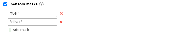

Sensor masks
Here you can specify the masks of the sensors which should be taken into account when executing the report. The specified masks influence:
- Sensors filter**;**
- values in the Counter, Initial counter, Final counter columns;
- values in the columns related to engine revolutions, temperature and fuel;
- custom sensor values if the Custom sensor masks filter is not used.
The mask of the engine hours sensor is specified separately in the Engine hours sensor filter.

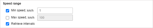

Speed range
Here in the Min speed and Max speed fields, you can the minimum and/or maximum unit speed required for the interval to be included in the report.
If you want the report to show only those periods during which the speed met the specified conditions, activate the Retrieve intervals option.

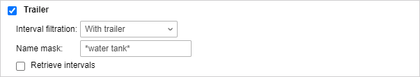

Trailer
The filter allows you to see the intervals within which a trailer or no trailers were assigned to the unit. The options in this filter work in the same way as the options in the Driver filter.

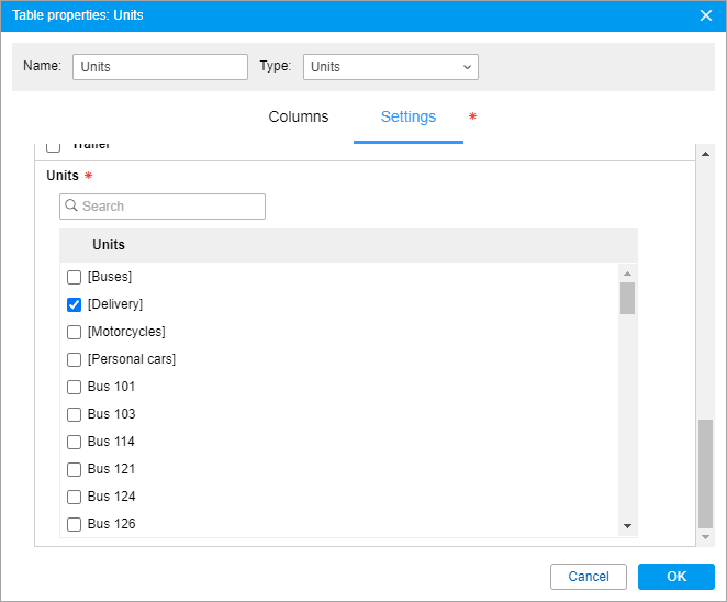

Units
This filter is used in reports on the assignments of passengers, trailers and their groups, as well as in reports of the Geofences and Groups of geofences types.
In the list, you can select units or unit groups which should be taken into account in the report.
