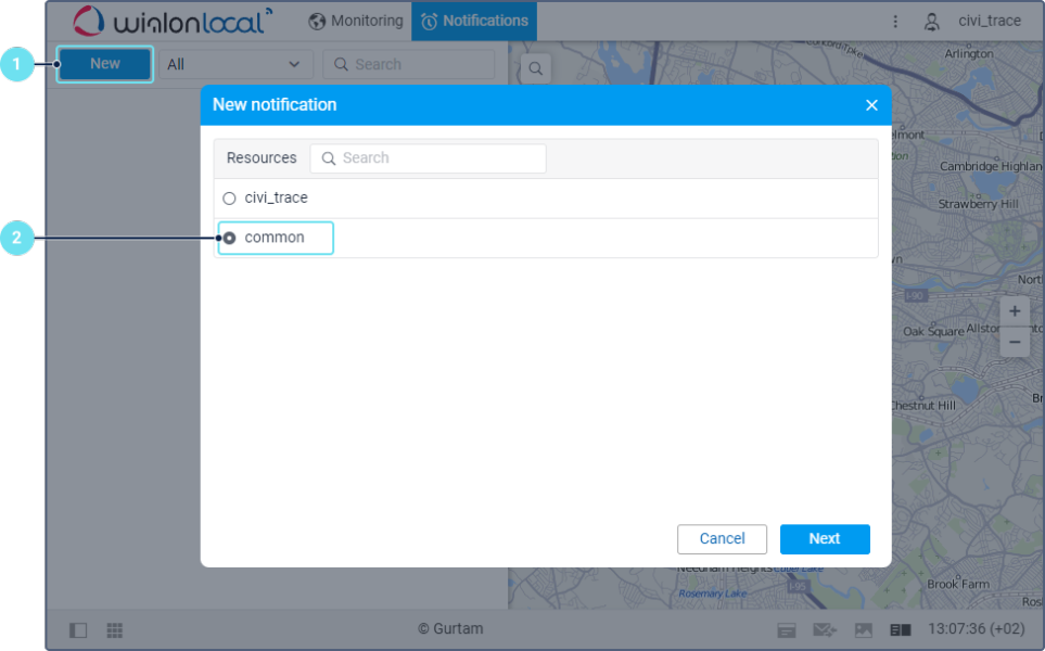

To create a notification, do the following:
  1. Click Create on the Notifications tab.
  2. Select the resource in which the notification should be stored.
