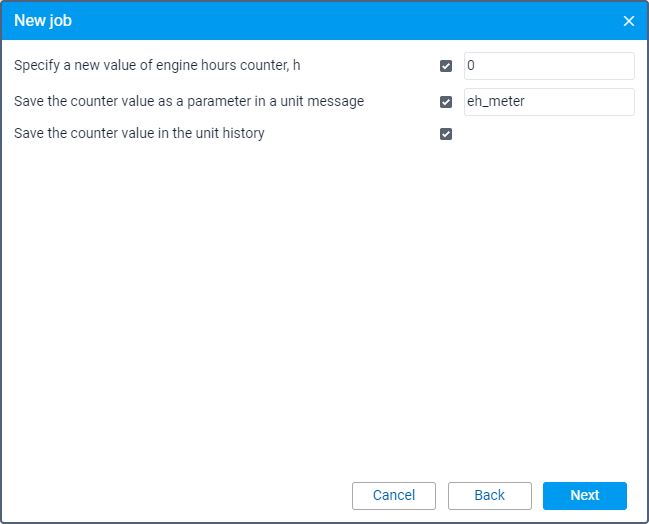

Save and/or change the value of the engine hours counter
The same actions are available in this job as in the previous one, but apply to the counter of engine hours.
You can select the following options:
| Option | Description |
| Specify a new value of engine hours counter | Allows resetting the engine hours counter to zero or specifying any value for it. For this purpose, enable the option and enter the value (in hours) which should be applied after the job is carried out. |
| Save the counter value as a parameter in a unit message | Allows saving the counter value as a parameter in a message. You can create a sensor of engine hours based on this parameter. The parameters saved this way are available in data messages. Their value is shown in seconds. To use the option, enable it and enter the parameter name in the field. You can use only latin letters, special characters are not allowed. If the parameter name consists of several words, use an underscore instead of a space (for example, eng_hours). It is advisable to save the counter values while the vehicle is parked, for example, once a day at night. |
| Save the counter value in the unit history | If the option is enabled, the counter value is saved in the unit history. As a result, an event is registered in the system and you can see it in the Events or Chronology tables in reports. |

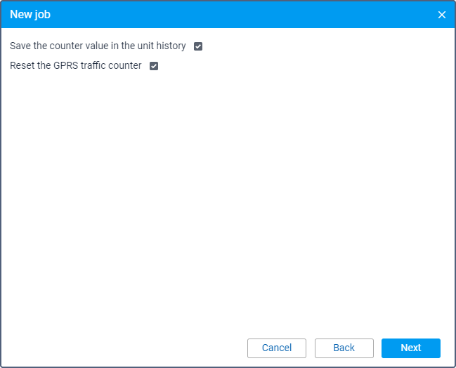

Save and/or reset the value of the GPRS traffic counter
The jobs of this type are usually used to:
- automatically reset the counter of consumed traffic on a regular basis (for example, once a month);
- save the values of consumed traffic in the unit history and run reports on it.
You can select the following options in the job settings:
| Save the counter value in the unit history | Allows saving the counter value in the unit history. As a result, an event is registered in the system and you can see it in the Events or Chronology tables in reports. If the Reset the GPRS traffic counter option is also enabled, the counter reset is saved as an event and is shown in the GPRS traffic table in reports. |
| Reset the GPRS traffic counter | Allows resetting the counter value to zero. |
