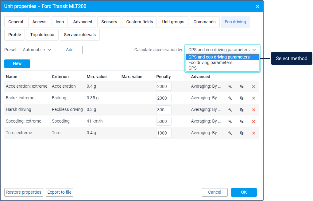

Three methods for calculating acceleration are available.
MethodDescription
GPS and eco driving parametersThe acceleration is calculated both according to the data on the unit location, speed, movement direction and time and on the basis of special parameters sent by devices: wln_accel_max, wln_brk_max, and wln_crn_max. Then the system selects a higher value.
Eco driving parameters
The acceleration is calculated by the device and is displayed in the device messages as special parameters which contain the maximum speed values for the period between two messages: wln_accel_max, wln_brk_max, and wln_crn_max. These parameters can be received only from some devices. The calculation method based on the eco driving parameters is more accurate because the calculation doesn't depend on the frequency of sending data.
The messages in which the unit location is determined by LBS or Wi-Fi points are not taken into account when calculating acceleration.
If the data that can be used to calculate acceleration is received in parameters other than wln_accel_max, wln_brk_max, and wln_crn_max, you should create sensors and custom criteria based on them. See a configuration example for Teltonika devices here.
GPSThe acceleration is calculated according to the data on the unit location, speed, movement direction and time. For a more correct calculation, set the minimum possible interval of sending messages on your device, but not less than 2 seconds. It is advisable to use this method only if you can't use the previous one.
By default, the acceleration is calculated according to the GPS and eco driving parameters method.
You can select the required calculation method depending on the type of equipment used.
The selected method is applied to all the configured criteria, except for the criteria of the Speeding and Custom types.
