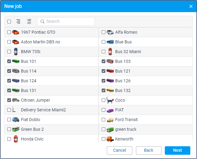

  2. Select the unit or units for which you want to create the job.

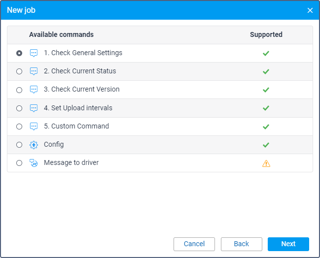

  3. Select the command which should be sent to the unit(s) and, if necessary, specify its parameters. The list displays all the commands created in the properties of the selected units. If a command is supported by all the units, the icon    is shown opposite it; if not by all the units, the icon  is displayed. In the tooltip to the icon  you can see which units support the command, and which don’t. These limitations may be due to the access rights or the device type.

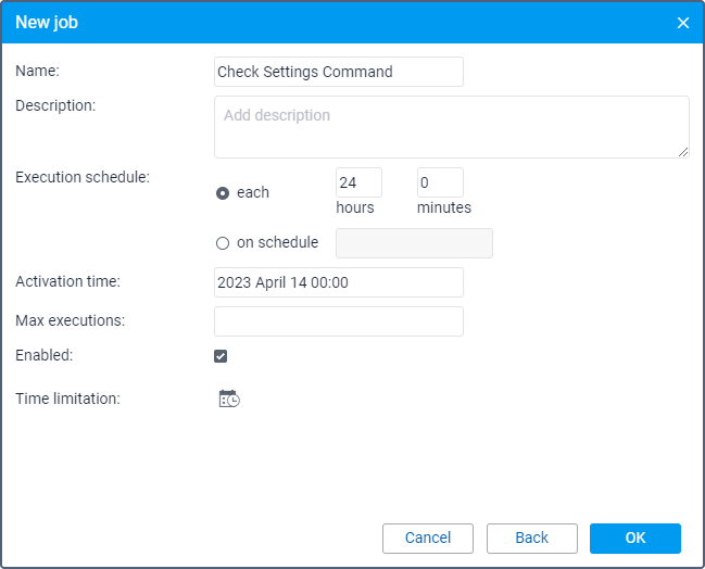

  4. Specify the job execution parameters.
  5. Click OK.
