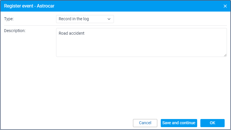

Record in the log
Using this option, you can add any text note to the unit log. It will be labelled as Manual record and dated by the time of creation. Such records can be viewed in messages (messages type Log) and in reports generated for this unit (query the Log table).

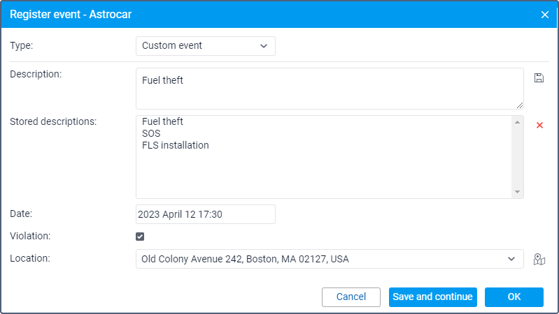

Custom event
To register a custom event, enter its name, description, and location. To add the location, click on the icon  to the right of it. On the map that appears, double-click on the required position. The address is defined by the maps selected as geodata source in the user settings. Gurtam Maps. In addition, the position can be entered manually. To clear the field, delete the address.
The description of the registered event can be saved. To do this, click on the Save icon to the right of it. The saved description appears in the list below. To select an existing description, click on it. To delete a description from the list, select it and click on the Delete icon.
If you check the Violation option, the event will be registered in the unit history as a violation, otherwise, it will be registered as a simple event. It means this event will appear in different kinds of reports: Events or Violations.

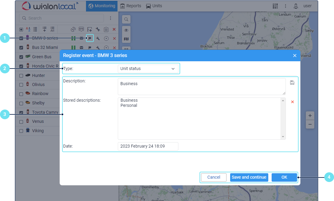

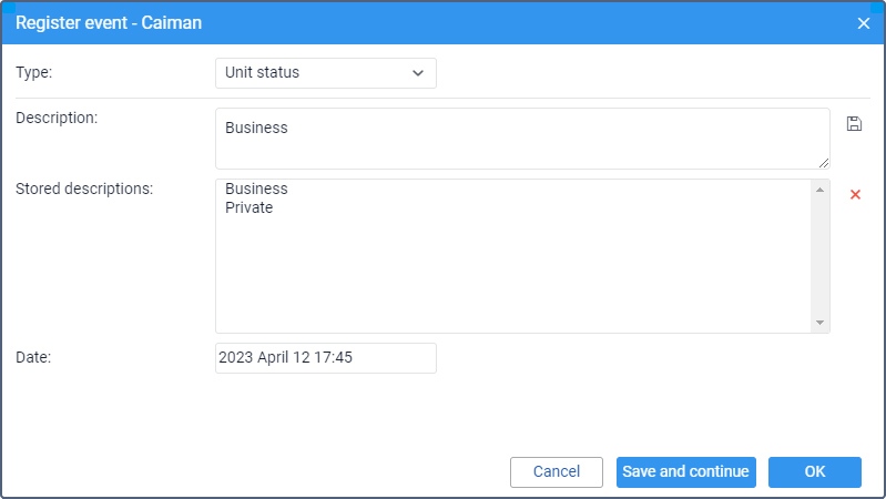

Unit status
This option allows registering the unit state which can be later displayed in reports. For example, when using a vehicle for personal and official purposes, you can register the start of personal or official use of the vehicle.
To register the unit status, type in a description (you can use the ones saved previously) and, if necessary, change the date and time of the status.
The status can be set automatically (for example, when entering a geofence).
The Status column is available in the following tabular reports: Trips, Engine hours, Trips between geofences, and Parkings.

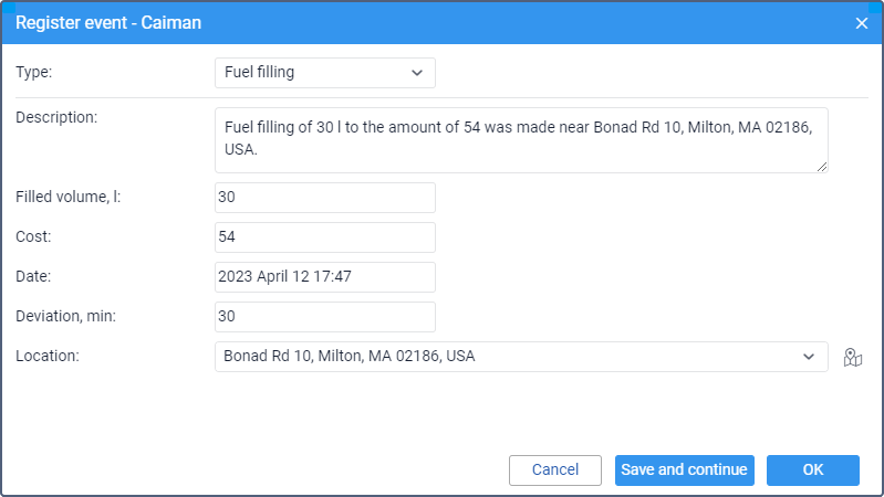

Fuel filling
On the Monitoring tab, you can manually register fuel fillings for units. Manual registration helps to estimate the difference between the registered fuel filling and the factual one, compare the consumed amount with consumption rates, calculate running costs, etc.
To register fuel filling, select the corresponding event in the drop-down list and fill in the required fields.
Enter the volume of filled fuel and its cost. Fractional numbers (up to hundredth) can be also used for fuel volume and cost. To enter fractional numbers, use a period as the separator. For example, to register fuel filling for 77 dollars and 88 cents, enter 77.88.
Entered values are automatically added to the Description field above. If necessary, you can edit the description manually. Then enter the date and time when the filling took place, possible deviation from this time in minutes and specify the location.
Registered fuel fillings participate in the following reports: Fuel fillings, Events, Utilization cost.

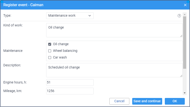

Maintenance work
To register maintenance work, select the corresponding event in the drop-down list and fill in the required fields.
Enter the following data:
  • kind of work (type from the keyboard or select from the list below);
  • description;
  • values of mileage and engine hours counters at the moment of the event (the current values are displayed but you can edit them);
  • cost;
  • service duration in minutes, hours or days (choose the type of the interval from the drop-down list);
  • date and time of maintenance (by default, the current date and time are displayed);
  • location (press the Select Location icon and double click on the map to specify the position or edit this field manually).
In the Mileage field, it is not possible to enter a value that exceeds 2147483 km.
In the upper part of the dialog, you see the list of service intervals from the Service intervals tab. Check the services that have been carried out. This is required in order for the selected intervals to be zeroed and the countdown to start anew. Keep in mind that if you select any maintenance interval here, the contents of the Kind of work field changes correspondingly.
