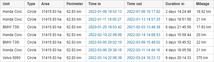

A template for the report on geofences and groups of geofences can contain a table of one type only: the Units table.
The Units table shows the information about what units visited the geofence or group of geofences, at what time they did it, how long they stayed there, at what speed they moved, etc.
The Units table can include the columns described below.
ColumnsDescription
UnitThe name of the unit which visited the geofence.
GeofenceThe name of the geofence the unit visited (only in reports on groups of geofences).
TypeThe type of the geofence (polygon, circle, or line).
AreaThe area of the geofence.
PerimeterThe perimeter of the geofence. In the case of a line, its length is considered to be the perimeter, that is, its thickness is not taken into account.
DescriptionThe description of the geofence (is taken from the geofence properties).
Time inThe time when the unit entered the geofence.
Time outThe time when the unit left the geofence.
Duration inThe time the unit stayed in the geofence.
Total timeThe time from the beginning of the first visit to the end of the last one.
Parkings durationThe total parking time in the geofence.
Off-timeThe time during which the unit was outside the geofence from the first exit to the last entrance to the geofence.
MileageThe mileage inside the geofence.
