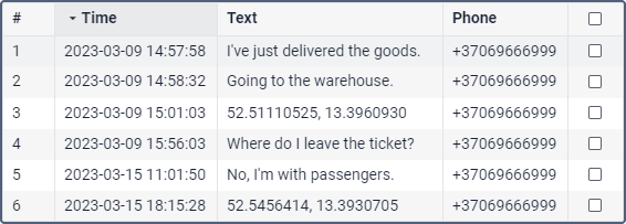

When you request this type of messages, you can see a table with the SMS messages sent to the server by the unit when executing commands, triggering the alarm, and in other cases depending on the device configuration.
The table can contain the following columns:
Column
Description
Time
The date and time of sending the message.
Text
The text of the message. You can filter the messages by text.
Phone
The phone number of the tracker SIM card from which the message was sent.
