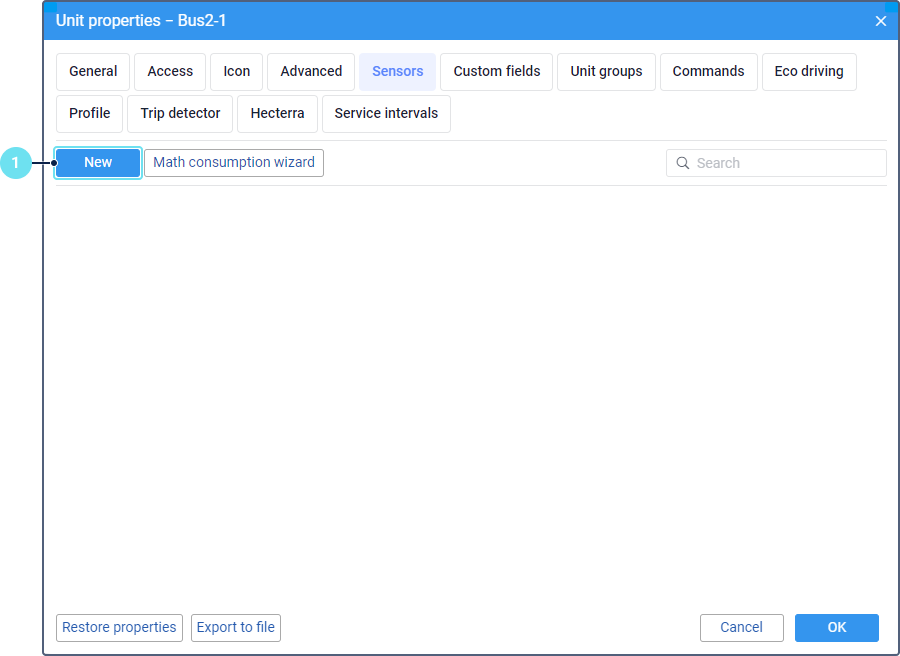

Click New (
) on the Sensors tab of the unit properties.

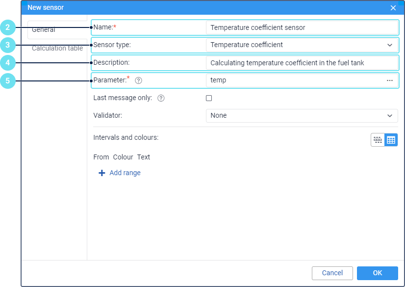

Enter the name of the sensor.
Select the Temperature coefficient sensor type.
If necessary, add a description.
Specify the parameter in which temperature data is received.

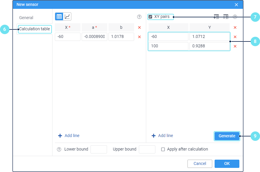

Go to the Calculation table tab.
Activate the XY pairs tool.
Add pairs with the coefficients for the minimum and maximum temperature using the calculated values.
Click Generate.

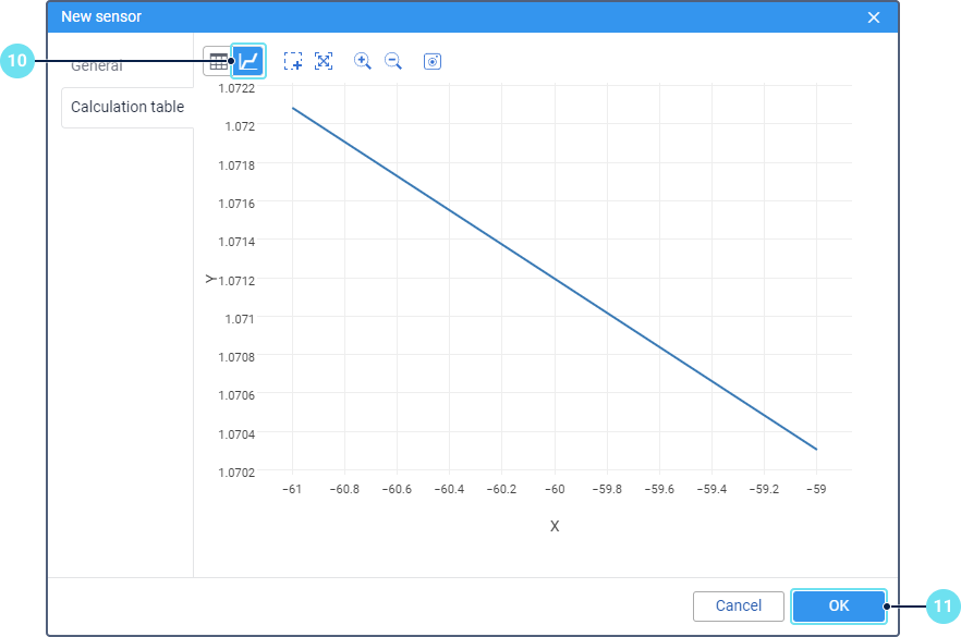

If you want to see the calculation result in the chart, click on the icon
above the table.
Click OK.

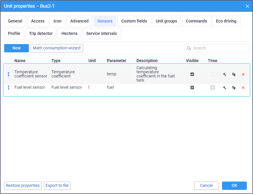

The temperature coefficient influences only the calculations carried out according to the fuel level sensor.
