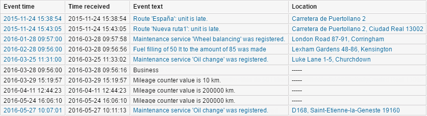

In the table settings, you can find a filter by event text. Specify the mask to which the event text should correspond to include this event in the report.
The table can contain the columns listed below.
ColumnDescription
Event timeThe time when the event happened.
Time receivedThe time when the server received the data.
Event textThe text that was specified when creating a notification or when registering an event manually.
Event type
The type assigned to the event during its registration (see the table above).
User
The name of the user who registered the event. If the event was registered automatically, the field contains the name of the creator of the resource to which the notification or job belongs. If the event type is route progress, the name of the user who created the route is shown. The user name is hidden if you don’t have access rights to view it.
LocationThe location of the unit at the moment of the event. If the event is registered manually, the unit's location is detected on the basis of messages received upon event registration. The same is true for the events registered by storing counters' values in the unit properties.
DriverThe name of the driver (if identified).
CountThe count of events.
Notification textThe text available upon registering an event from an online notifications window.

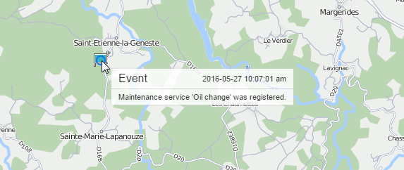

Besides, you can use special markers for this report: a green flag stands for an event, a red flag — for a violation. In the tooltip, you can find detailed information. You can add the markers of events and violations by activating the option Event markers in the settings of the report template (Map output section).
