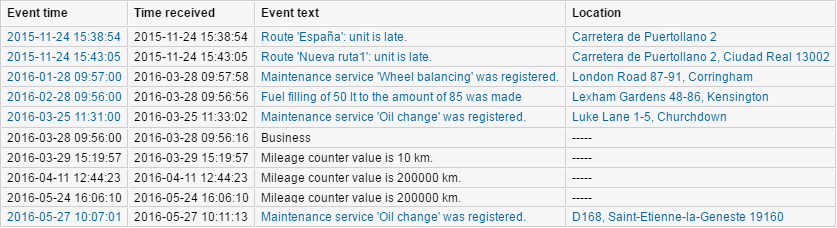

The table can contain the columns listed below.
ColumnDescription
Event timeThe time when the event happened.
Time receivedThe time when the server received the data.
Event textThe text that was specified when creating a notification or when registering an event manually.
LocationThe location of the unit at the moment of the event. If the event is registered manually, the unit's location is detected on the basis of messages received upon event registration. The same is true for the events registered by storing counters' values in the unit properties.
DriverThe name of the driver (if identified).
CountThe count of events.
Notification textThe text available upon registering an event from an online notifications window.

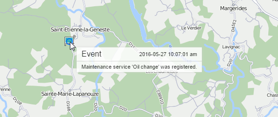

Besides, you can use special markers for this report: a green flag stands for an event, a red flag — for a violation. In the tooltip, you can find detailed information. You can add the markers of events and violations by activating the option Event markers in the settings of the report template (Map output section).
