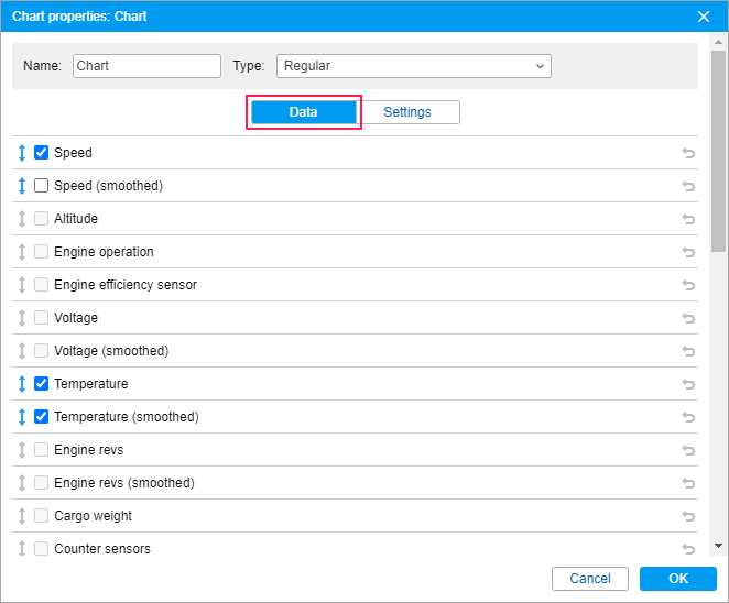

On the Data tab, you can select the curves that should be displayed in the chart. The selection is only available for charts of the Regular type.
Mark the curves you want to see in the report. Two points can be checked simultaneously. In this case, two curves are displayed, for instance, speed and engine revs. There can be more curves, but only if there are no more than two variables in the chart, besides time.
To change the name of the point, click on it with the left mouse button and edit the text. To return the original name, click on the Default icon (). The icon is inactive if the name has not been changed.
In addition, it is possible to change the order of the items. To do this, drag the icon  located to the left of the required curve, up or down.

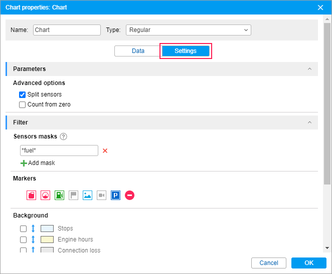

In addition to selecting columns, the settings are available on the same-name tab.
The tab is divided into two sections:
Parameters
In the Parameters section, it is possible to activate the Split sensors and Count from zero.

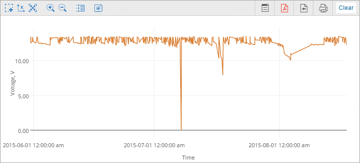

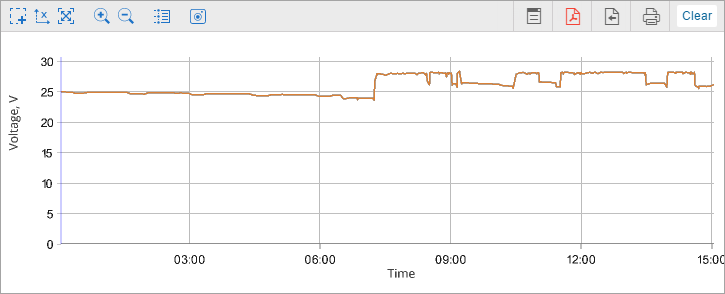

The Count from zero option is responsible for scaling the chart. By default, the range of the Y scale depends on the range of values falling within the specified interval. That is, if, for example, the temperature fluctuates from 3 to 5 degrees, then the reading on the Y scale starts at 3, and the curve, in this case, occupies the maximum space on the chart. If the Count from zero option is activated, the Y-axis on the graph is always built from zero to the largest value (if the values ​are negative, then from the lowest value to zero).
The image below shows an example of two voltage charts for the same unit within the same time interval. The first chart is regular, the second — with the Count from zero option turned on.

The following settings are available in the Filter section:
  • Sensor masks;
  • Markers;
  • Background;
  • Line color.
Sensor masks
This option allows you to specify the sensors on the basis of which the chart should be built. The option does not influence the Speed, Altitude, Fuel consumption by math charts, as they can be built regardless of whether a unit has sensors or not.
Specify the mask of the required sensor. To do it, enter its full name or part of the name. You can use special characters: * (replaces any number of characters) or ? (replaces one character). The name of the sensor cannot contain commas.
If the masks are not specified, the sensors of the required for building the chart type are determined automatically.
