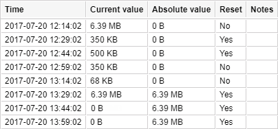

GPRS Traffic
This report is executed if a unit has registered events of GPRS traffic counter reset or traffic storage was adjusted with the help of a corresponding job.
ColumnDescription
TimeThe time when the counter value was registered.
Current valueThe value at the moment of registration.
Absolute valueThe total size of GPRS traffic at the moment of registration.
ResetDetermines whether the reset of GPRS traffic was detected. Yes — detected, No — not detected.
NotesAn empty column for your custom notes.
