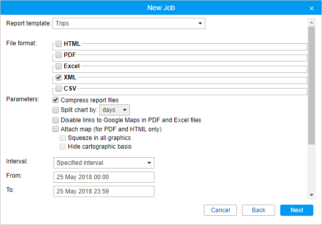

To configure sending the report by email, specify the parameters described below.
Resource
In the drop-down list, select the resource to which the required report template belongs. To view the templates of all resources available to the user, select All available.
Report template
In the drop-down list, select the required report template. The list shows only the templates that belong to the selected resource.
File format
Check the format (formats) in which the report should be sent. The following formats are available: HTML, PDF, Excel, XML and CSV. More information about file formats and their parameters can be found on the Export report to file page.
Parameters
Specify additional report parameters:
  • compress report files (HTML files and files larger than 20 MB are always archived),
  • split chart by days/weeks,
  • disable links to Google Maps in PDF and Excel files,
  • attach map (for PDF and HTML formats only).
If the map is attached, the Squeeze in all graphics and Hide cartographic basis options become available.
Interval
Specify the reporting period. For the For previous… interval, it is possible to activate the Including current option so that the report is executed not for the latest full period, but for the current one.
