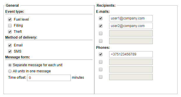

Set additional report parameters:
  • Event type: fuel level, filling, theft (you can select all three).
  • Method of delivery: by email and/or SMS. On the right, enter your email(s) and phone number(s) in the international format.
To be able to send text messages, the Can send SMS option must be activated in the user properties.
  • Message form: one unit in one message or all units in one message.
  • Time offset (in minutes): this option allows you to analyze messages from the black box. The time of the last job execution minus the offset will be considered the beginning of the interval, and the current time will be viewed as the end of the interval.
