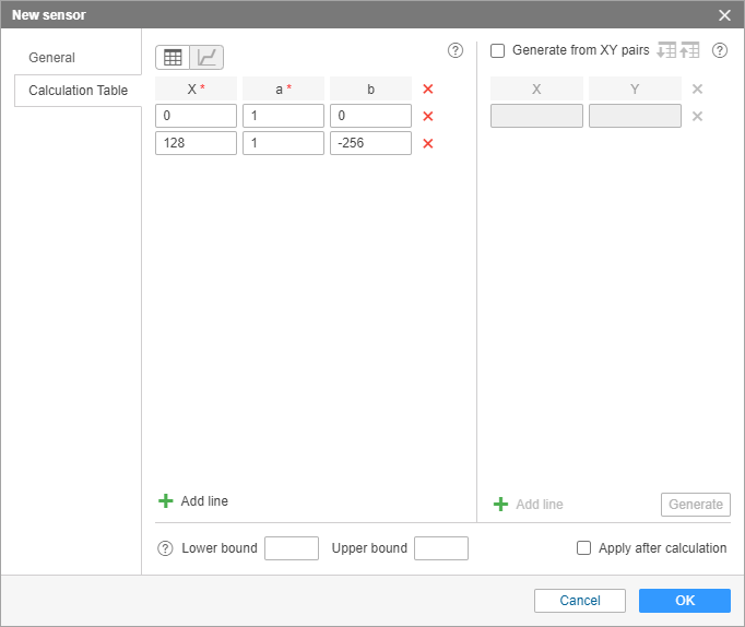

As an example, let us create a calculation table for the temperature sensor. Suppose that the data is coming in complement code, i. e. the positive values are from 0 to 127, and negative from 128 (which corresponds to -128 degrees) to 255 (which corresponds to -1 degree).

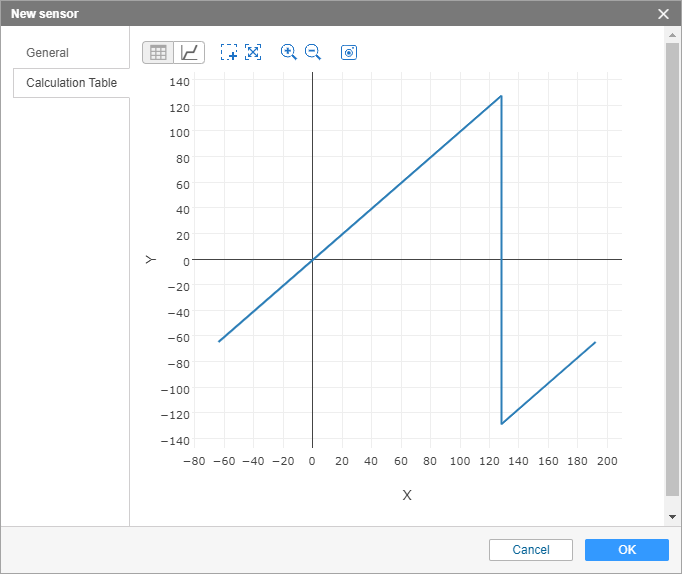

On the basis of the values indicated in the table, a chart is made. To view the chart, click the Show chart icon.
The calculation graph always has a somewhat extended view — along the X axis it stretches to the right and to the left. This is due to the fact that on the first interval the function also works in the opposite direction — up to minus infinity, and on the last interval — up to plus infinity.

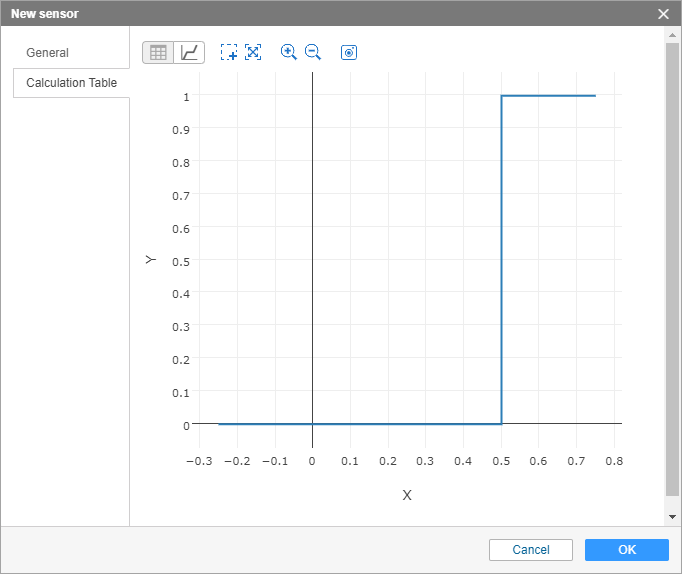

It is possible to configure a non-digital ignition sensor based on the parameter sending voltage. For instance, the voltage up to 0.5 V would mean ignition off, and over 0.5 V — ignition on. For such a sensor, we should create a calculation table as shown below:
Move to the Calculation chart and see if the result meets your expectations.

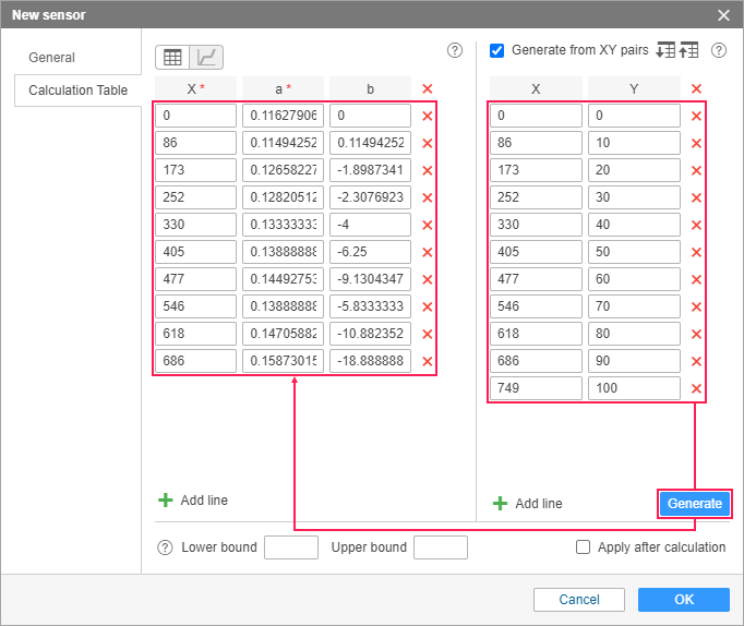

Enter these pairs into the wizard and click Generate. Based on the entered values, a calculation table (on the left) is generated.
In order to view a chart, click the Show chart icon.
All the data entered and saved on this tab is available when you open the dialogue box. Any changes in the calculation table do not affect the Wizard. In other words, the Wizard only shows the entered values but does not reflect the current situation.
Now let us see how a and b were calculated. The first interval starts with 0 and lasts until 86. At that, at the last point the output is 10. So, X displacement is ∆Х = 86 — 0 = 86, and Y displacement is ∆Y = 10 — 0 = 10. Now a coefficient can be calculated: a = ∆Y/∆X = 10 / 86 = 0,11627906976744186.

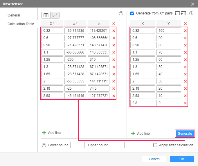

In this example, input X values decline while output Y values grow. Insert the pairs into the Wizard in any order — they will be rearranged automatically.
Initial data:

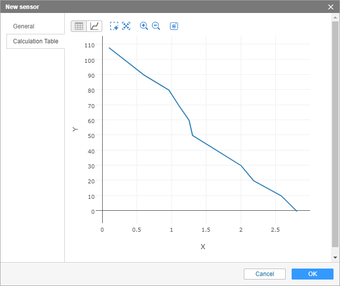

Enter these pairs into the Wizard, generate the calculation table and view the calculation chart.
Calculated intervals for this sensor are as follows:
