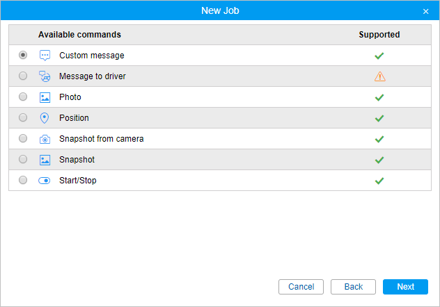

For the Send a command to units job, select a command that should be executed.
Some of the units might not support the selected command. Restrictions can be placed due to the absence of access rights or the device type in use.
Pay attention to the icons in the Supported column:
  • means that all the selected units support the command;
  • means that not all the selected units can execute the command (for more information about the restriction, see details in the tooltip).
For some commands, you should set additional parameters, such as the input/output number, online report interval, and so on. More information about executing commands you can find here.
