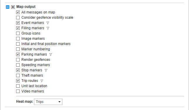

The lines of the online report, which contain information about the location of the unit at the time of an event, are highlighted in blue. If you click on the line with the left mouse button, the message is marked on the map with a special marker, and the map, in turn, is centered on its location. A similar option works for some Regular charts (where the X scale represents time): when using the trace tool, you move to the message on the map.
Some elements can be drawn on the map as a part of the report. They can be selected in the Map output section of the report template dialog. These can be tracks traveled by unit, geofences, as well as special markers in the form of small icons which can be put in the places of events, fillings, thefts, speedings, etc. All this is configured when creating or editing a report template on the Settings tab in the Map output section.
Some data can also be displayed in the form of a heat map. Its color varies from blue (minimum) to red (maximum) depending on the amount of data. In the drop-down list of the Heat map field, select one of the options:

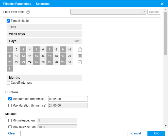

Graphical elements filtration
Interval filtration is supported for some graphical elements (e.g. markers of speedings, events, fillings, thefts, parkings, and stops, as well as trip routes) adjusted upon working with a report template. To set interval filtration means to indicate parameters considered for displaying graphical elements on the map. The values of filtration parameters are indicated for each element individually. A set of available filtration parameters for such an element corresponds to a set used for the interval filtration in a similar-type table.
To open the filtration parameters dialog, it is necessary to click on the corresponding icon (
) to the right of a graphical element. Note that to set the filtration parameters, it is required to select the option of a corresponding graphical element first.
If interval filtration has been already set for a table of the corresponding type, and such a filtration needs to be set for displaying graphical elements on the map as well, you can facilitate a process of indicating the filtration parameters by uploading those applied to the table. To do so, select a corresponding table in the drop-down list (the first line of the dialog) and click Upload.
To reset the indicated filtration parameters, click Clear. To leave the dialog without applying changes, press Cancel. To apply selected settings, click OK.
The filtration set for displaying graphical elements on the map also affects the corresponding markers and backgrounds chosen for charts.
Tracks in reports
The routes traveled by a unit in a selected period of time can be shown on the map. To do this, select one of the options: Trip routes or All messages on map in the report template dialog. In accordance with the first option, only the intervals considered as trips (according to the trip detector) are displayed as tracks with different colors. In the case of the All messages on map option, all the messages with valid coordinates are converted into a track regardless of trips, parkings, stops, etc. If in the unit history there are intervals where the connection was lost (there were no messages for a long time) or coordinates were not determined in messages, such intervals are displayed with a dashed line.

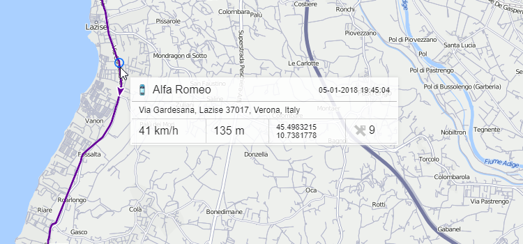

Besides, to get the information about track points, hover the mouse cursor over and see the information in a tooltip (time, speed, coordinates, altitude, sensor values). Note that messages are searched in the radius of 50 pixels to the cursor.

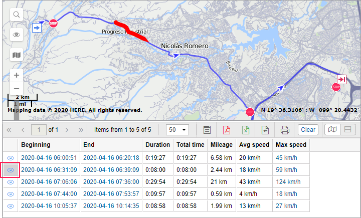

If you enable the Trip routes or All messages on map option in a report on units or unit groups, then such tables as Engine hours, Trips between geofences, Speedings, Trips have an additional first column with the icons
. After clicking on the icon, the map is centered on the corresponding segment of the track which is highlighted with a red line. This function is also available for the Trips table in reports on drivers.

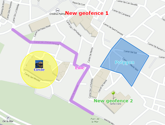

Geofences in reports
Created geofences can be a part of a report. They are displayed on the map if you enable the Render geofences option in the Map section of the report template.
Geofences are taken only from the same account as the report template itself.
Geofences are displayed with their captions and images or icons (if you have selected any). The color and the font size of the caption is taken from their properties. Apart from that, additional options can be applied to geofences.
Group icons
The geofences that overlap each other can be replaced by one conditional item, and its tooltip contains detailed information. The same can be applied to markers.
Consider geofence visibility scale
By default, all the geofences are rendered on the map. However, they can be seen or hidden according to their visibility parameter set in the properties.

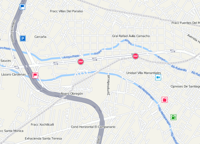

Markers in reports
Most types of reports can have additional information visualized on the map with the help of special markers. To get these markers in a report, select the required markers in a report template.
The table below presents all possible markers and their icons.
Parking marker | Marks a location where, according to the trip detector, a parking takes place. The tooltip displays the beginning of a parking time and parking duration. | |
Stop marker | Marks a location where, according to the trip detector, a stop takes place. The tooltip displays the beginning of a stop time and stop duration. | |
Filling marker | Marks a location where, according to sensors data, a fuel filling takes place. The tooltip displays filling time and the amount of fuel filled. | |
Theft marker | Marks a location where, according to the sensors data, a fuel theft takes place. The tooltip displays theft time and the amount of fuel stolen. | |
Event marker | Marks the locations where events were automatically registered by means of notifications. The events registered manually, including fuel fillings, are also shown by such markers if a location (and preferably a description) is indicated during event registration. The tooltip displays the event time and the text of the event. | |
Violation marker | If you select event markers, then both event and violation markers are to be displayed because a violation is a special case of an event. | |
Speeding marker | Marks a location where speed limits indicated in the unit properties were violated. The tooltip displays the initial time of the speeding interval (i.e. the time of receiving the first message with a speed value exceeding the allowed one), the allowed speed (indicated in the unit properties), the value of speeding and the total duration of a speeding interval. | |
Image marker | Marks a location where pictures from a unit were received. | |
Video marker | Marks a location where videos from a unit were received. | |
| Initial position marker | Marks the initial position of the trip according to the trip detector. The tooltip displays an address. | |
| Final position marker | Marks the final position of the trip according to the trip detector. The tooltip displays an address. |
The panoramic images of the territory can be displayed when clicking on the markers of parkings and stops. For this, maps with panoramas (for instance, Yandex Panorama or Google Street View) should be selected in the user settings. If there are pictures of the territory with the coordinates of the marker, when pointed at it, the cursor changes from arrow to hand. Click on the marker to open a panorama snapshot in the window of the Address tool. Double-click on another such marker to update the information.
When enabling event markers, in addition to event markers you get violation markers because a violation is a special case of an event.
Markers appear on the map after a report is generated. If you see no markers, it means there are no events of the indicated type or the current map scale is not enough (try to zoom in).
When you point to a marker, you see additional information in a tooltip: starting time and duration for stops and parkings, time and notification text for events and violations, time and fuel volume for fillings and thefts, for speedings — starting time, speed limitation as it is defined in unit properties, how much the speed is exceeded, and duration of this speeding.
Markers, as well as geofences, can be grouped in case they overlap each other. To enable grouping, activate the Group icons option in the report template. If there are 1000 or more markers, their grouping is enabled automatically. The group icon shows the number of grouped elements. In the icon tooltip, you can see detailed information about the events.
If more than 100 markers are grouped, the tooltip contains only their names without the detailed information.
You can enable the Marker numbering option in a report template. In this case, each marker has its sequence number which is indicated below the marker in red color. Numbers are assigned chronologically, and each marker type has its own enumeration.
