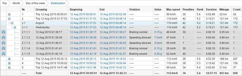

Note that it is easier to analyze the received report if the grouping option was applied to the report template. The information received in the report can be grouped on the basis of different criteria, such as time (year, month, week, day, shift), type of violation and trips.
Moreover, in addition to grouping, an option of detalization can be applied. This option allows viewing the final level of nesting (date and time) inside of grouping. However, take into consideration that a penalty and rank can be given for a violation that occurred at a certain time interval (not immediately). That is why on the final level of nesting (date and time) a dash is given in the Rank column, and the Penalties column receives the value indicated on the Eco driving tab of the unit properties.
If you use grouping or add the Total line to the table, the Duration, Mileage and Driver columns show the data on the trips (not violations) of the specified time interval.
