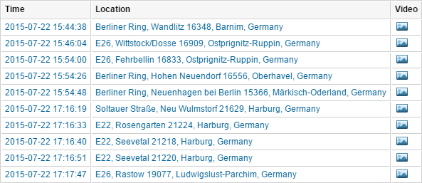

The Video table provides you with a list of video files received from a unit. The table can contain three columns.
| Column | Description |
| Time | The time a video file was received. |
| Location | The location of a unit when sending a video file. |
| Video | An icon that opens a video. |
