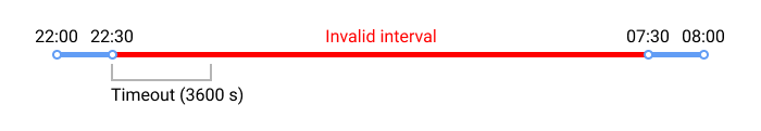

Timeout
The Timeout option is applied only to historical data (reports). The option is used to search for invalid intervals during the sensor operation. If an interval between two messages with sensor data is longer than the value indicated for the Timeout option, the interval is considered invalid and is removed from the report. In this case, the message before the invalid interval becomes the end of one interval and the message after the invalid interval becomes the beginning of the next one. The timeout is specified in seconds.
If you specify 0 in the field or leave it blank, the option is considered disabled.
Example. Suppose that data messages from a custom digital sensor were received at 22:00, 22:30, 07:30 and 08:00. If the Timeout option is disabled, the report shows one continuous interval from 22:00 to 08:00. If you specify a timeout of 1 hour (3600 sec), several intervals are formed. Since the difference between the first and second messages is less than an hour, they form the first interval (from 22:00 to 22:30). The difference between the second and third messages is more than an hour, therefore this interval (from 22:30 to 07:30) is considered invalid and is not taken into account. The difference between the third and fourth messages is less than an hour, therefore they form the second interval (from 07:30 to 08:00).
