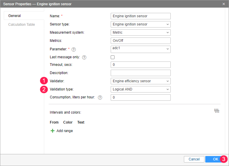

Validation determines the dependence of the main sensor on a validator and makes it possible to combine their values to get one final value. You can configure validation by selecting a validator and validation type in the sensor properties.
A validator is a validation sensor that can change the value of the main sensor. The validator is selected from the list of available sensors that were created earlier for the same unit.
