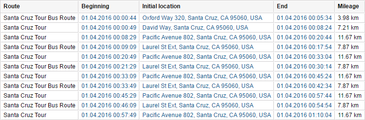

If any routes were assigned to a unit and events about routes were stored in the unit history, a report based on these events can be generated. The report can contain the columns described below.
ColumnDescription

In a report template, you can indicate name masks for schedules and routes. In this case, only those rides that correspond to the specified route or schedule name mask will be included in the report. You can use both filters separately or simultaneously.
In addition, you can apply interval filtration by duration, mileage, engine hours, speed range, trips, stops, parkings, sensors, driver, trailer, fuel thefts and fillings.
