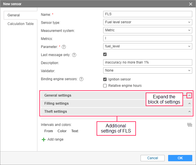

Additional Settings of FLS
The fuel level sensor has additional settings that are contained in three nested blocks: General settingsFilling settingsTheft settings.
