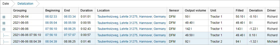

This report is designed to display the data about fuel fillings and thefts, as well as the intervals of operation of the counter sensor of the unit in one table. For each type of activity (fuel filling, theft, counter operation) you can customize its interval filtration in the parameters of the table.
If in the filtration parameters there are other selected units and at the moment of activity they were close to the unit for which the report is executed, the algorithm of fuel fillings analysis is run. Thus, when executing, for example, a report on a tanker, one can see not only its fuel activity but also the amount of fuel received by the units near it (at least one message from such units should be received during the activity interval from a distance less than the radius specified in the filtration parameters).

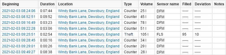

The Fuel traffic report can include the columns described below.
ColumnDescription
BeginningThe activation time of the sensor, the time of the fuel filling or theft depending on the type (see below).
EndThe deactivation time of the sensor, the time of the fuel filling or theft depending on the type.
DurationThe time from the beginning to the end (0 for fuel fillings and thefts).
LocationThe position of the unit while sending the data (is associated with the End field).
TypeThe kind of the current activity determined by the system (filling, theft, counter operation).
VolumeThe quantity calculated by the counter sensor or the data from the Filled or Stolen columns taken from the columns of the same name in the corresponding tables depending on the type.
Sensor nameThe name of the sensor by which the type was determined.
Geofences/UnitsThe column that includes the names of the geofences or units with which an intersection was recorded during a given interval. Necessary geofences and units are indicated in the filtration parameters. If there are several geofences or units that have been triggered, the report displays the name of the geofence with the smallest surface or the name of the unit with the smallest radius of approximation. If the sizes coincide, all the names are included.
FilledThe sum of the fuel fillings (if any) of the units shown in the Geofences/Units column. Only the fillings registered automatically and the time of which is within the interval from Beginning to End are taken into account.
DeviationThe difference between the values of the Volume and Filled columns.
DriverThe name of the driver assigned to the unit on the current interval.
NotesAn empty column where you can introduce your custom comments after you have printed or exported the report.
