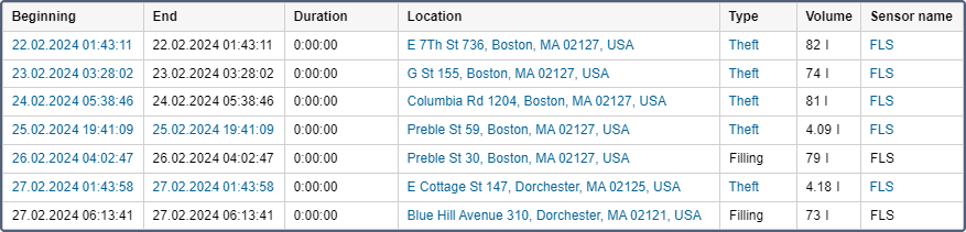

The Fuel traffic table can include the columns described below.
ColumnDescription
BeginningThe activation time of the sensor, the time of the fuel filling or drain depending on the type (see below).
EndThe deactivation time of the sensor, the time of the fuel filling or drain depending on the type.
DurationThe time from the beginning to the end (0 for fuel fillings and drains).
LocationThe position of the unit while sending the data (is associated with the End field).
TypeThe kind of the current activity determined by the system (filling, drain, counter operation).
VolumeThe quantity calculated by the counter sensor or the data from the Filled or Drained columns taken from the columns of the same name in the corresponding tables depending on the type.
Sensor nameThe name of the sensor by which the type was determined.

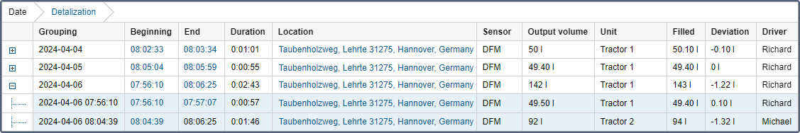

Geofences/UnitsThe column includes the names of the geofences or units with which an intersection was recorded during a given interval. Necessary geofences and units are indicated in the filtering parameters. If there are several geofences or units that have been triggered, the report displays the name of the geofence with the smallest surface or the name of the unit with the smallest radius of approximation. If the sizes coincide, all the names are included.
FilledThe sum of the fuel fillings (if any) of the units shown in the Geofences/Units column. Only the fillings registered automatically and the time of which is within the interval from Beginning to End are taken into account.
DeviationThe difference between the values of the Volume and Filled columns.
DriverThe name of the driver assigned to the unit on the current interval.
NotesAn empty column where you can introduce your custom comments after you have printed or exported the report.
