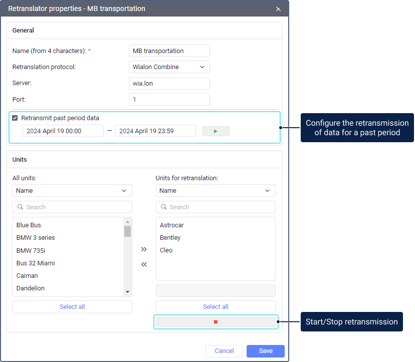

Retranslator properties
To open the properties of a retranslator, click on its row. The window of the properties is similar to the retranslator creation window. The only difference is that the properties contain the Retransmit past period data option, as well as the button /  for starting and stopping data transmission.

Retransmitting data for a past period
To transmit unit messages for a past period, follow these steps:
  1. In the retranslator properties, enable the Retransmit past period data option. The option is available only if the retranslator is started.
  2. Specify the period for which you want to transmit data.
  3. Click on the button  to the right of the specified period.
The percentage of units for which data transmission has already ended is shown in the History column of the retranslator table.
